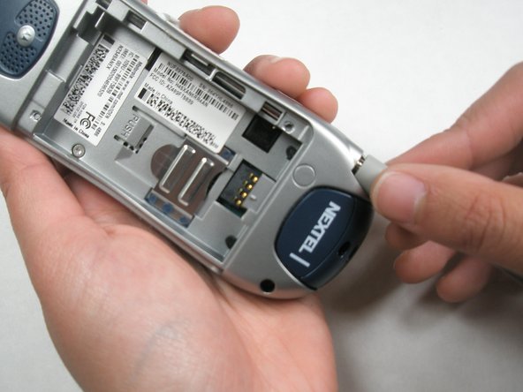

      • Press thumb against the top of the rear casing as shown and push down as you slide the casing off of the body.
      • You should hear a click as the latches on the casing disengage.

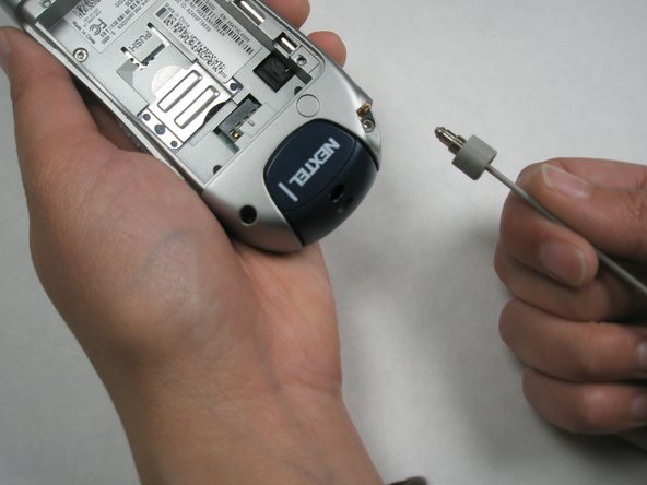

      • To remove the antenna, first extend it all the way.
      • Grab the rubber end connected to the phone and twist counterclockwise until the antenna comes out altogether.
      • If the rubber end won't twist manually, try using pliers to get it started.

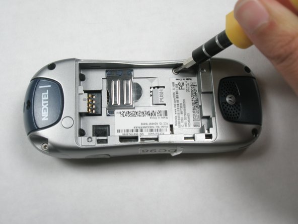

      • Locate all five screws on the phone, as indicated.
      • Using a T-6 screwdriver, remove each screw by turning it counterclockwise until it is free of the casing.

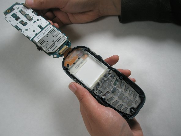

      • Place your thumb at the bottom of the logic board. Carefully lift up with your thumb to lift the logic board out of the casing.
      • Note: Do not try to completely remove the circuit board from the phone as it will be connected to the electrical strip at the top of the phone.
    5. Disassembling Motorola i265 LCD Screen: crwdns2935265:08crwdnd2935265:01crwdnd2935265:03crwdne2935265:0 Disassembling Motorola i265 LCD Screen: crwdns2935265:08crwdnd2935265:02crwdnd2935265:03crwdne2935265:0 Disassembling Motorola i265 LCD Screen: crwdns2935265:08crwdnd2935265:03crwdnd2935265:03crwdne2935265:0
      • Locate the switch connecting the the logic board to the electrical strip.
      • Slide spudger under the switch and lift up to free the strip. This will separate the logic board from the phone cover

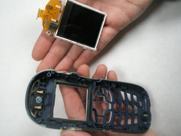

      • To fully remove the LCD screen, flip the casing over so that the top face of the phone is in your palm. The LCD screen should fall out of the casing.
      • Avoid as much contact with the actual screen as possible. Pressure on the screen may damage it.
