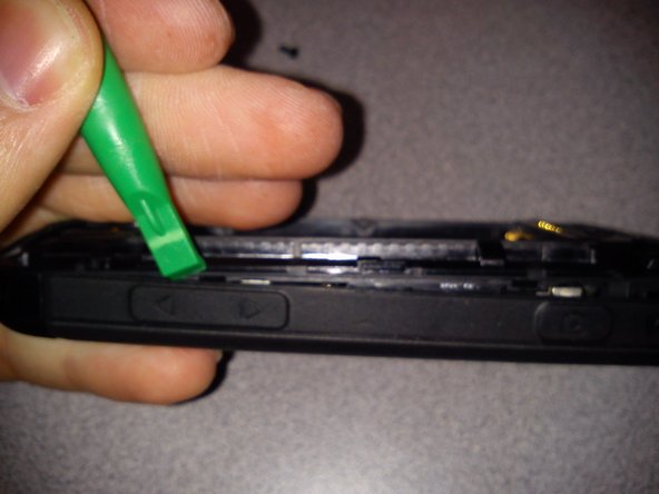

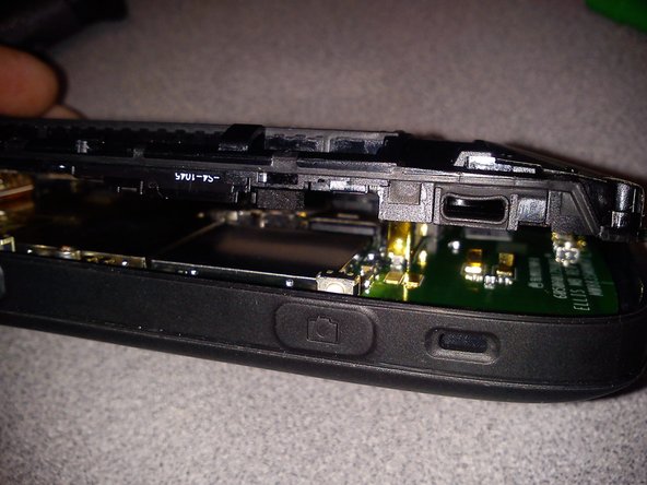

      • After all 6 screws have been removed, start by using a plastic pry tool to separate the back panel from the side frame.
      • Continue along the side near the volume buttons slowly seperating the back panel from the frame.
      • Once the back panel has been seperated from the frame slowly take it off, being careful not to break any plastic parts/clips.
      • Keep track of your screws.
    4. Disassembling Motorola ES400: crwdns2935265:04crwdnd2935265:01crwdnd2935265:01crwdne2935265:0
      • Remove the back panel and set it aside.

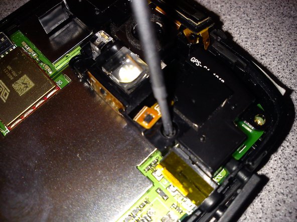

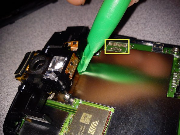

      • Unscrew the 2 Philips head (+) screws to remove the camera flash module.
      • This unit has a broken micro usb charging port.

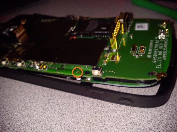

    10. Disassembling Motorola ES400: crwdns2935265:010crwdnd2935265:01crwdnd2935265:02crwdne2935265:0 Disassembling Motorola ES400: crwdns2935265:010crwdnd2935265:02crwdnd2935265:02crwdne2935265:0
      • Slowly lift the logic board out of the frame starting at the bottom of the phone.
      • (Fingers are released shown in orange)
