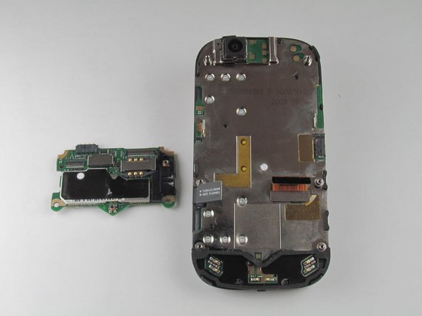

  9. Disassembling Motorola Cliq LCD Shield Plate, Motherboard: crwdns2935265:09crwdnd2935265:01crwdnd2935265:02crwdne2935265:0 Disassembling Motorola Cliq LCD Shield Plate, Motherboard: crwdns2935265:09crwdnd2935265:02crwdnd2935265:02crwdne2935265:0

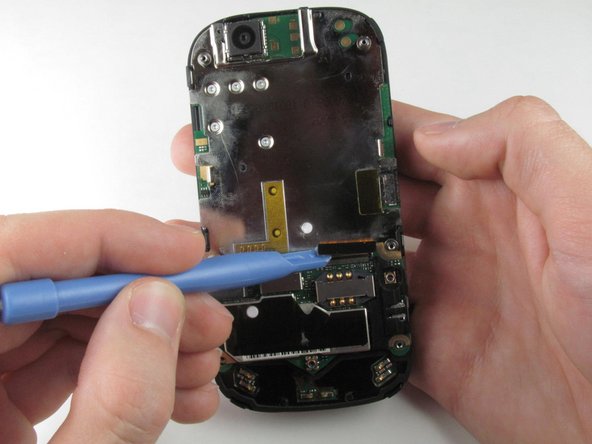

    • Wedge the plastic opening tool underneath the black display connector and pry it off its socket on the motherboard.
  10. Disassembling Motorola Cliq LCD Shield Plate: crwdns2935265:010crwdnd2935265:01crwdnd2935265:02crwdne2935265:0 Disassembling Motorola Cliq LCD Shield Plate: crwdns2935265:010crwdnd2935265:02crwdnd2935265:02crwdne2935265:0

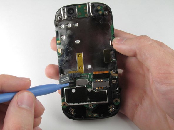

    • Pry the orange keyboard connector from its socket on the motherboard using the edge of the plastic opening tool.

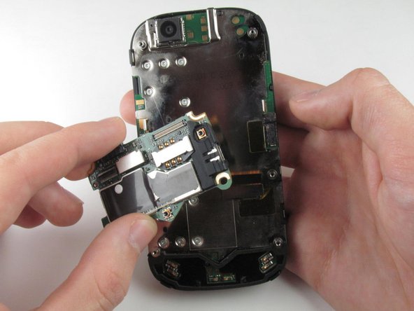

  11. Disassembling Motorola Cliq LCD Shield Plate: crwdns2935265:011crwdnd2935265:01crwdnd2935265:03crwdne2935265:0 Disassembling Motorola Cliq LCD Shield Plate: crwdns2935265:011crwdnd2935265:02crwdnd2935265:03crwdne2935265:0 Disassembling Motorola Cliq LCD Shield Plate: crwdns2935265:011crwdnd2935265:03crwdnd2935265:03crwdne2935265:0
    • Carefully grab the sides of the motherboard with your fingers and remove it from the phone.

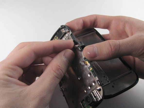

  13. Disassembling Motorola Cliq LCD Shield Plate: crwdns2935265:013crwdnd2935265:01crwdnd2935265:03crwdne2935265:0 Disassembling Motorola Cliq LCD Shield Plate: crwdns2935265:013crwdnd2935265:02crwdnd2935265:03crwdne2935265:0 Disassembling Motorola Cliq LCD Shield Plate: crwdns2935265:013crwdnd2935265:03crwdnd2935265:03crwdne2935265:0
    • Orient the phone so that the edge closest to the camera points towards you and slide out the keyboard.
    • Wedge the tip of a spudger between the keyboard and the display assembly below the camera.
    • With steady pressure, pry the keyboard away from the display assembly.
    • The keyboard and display assembly are glued together, so expect some resistance.
    • Do not completely separate the keyboard and display assembly because the display flex cable still connects them.

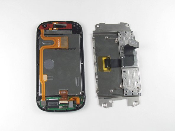

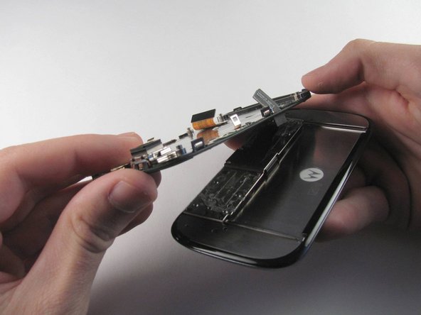

  14. Disassembling Motorola Cliq LCD Shield Plate: crwdns2935265:014crwdnd2935265:01crwdnd2935265:03crwdne2935265:0 Disassembling Motorola Cliq LCD Shield Plate: crwdns2935265:014crwdnd2935265:02crwdnd2935265:03crwdne2935265:0 Disassembling Motorola Cliq LCD Shield Plate: crwdns2935265:014crwdnd2935265:03crwdnd2935265:03crwdne2935265:0
    • Grab the display flex cable and gently push it through the notch it is coming out of.
  15. Disassembling Motorola Cliq LCD Shield Plate: crwdns2935265:015crwdnd2935265:01crwdnd2935265:03crwdne2935265:0 Disassembling Motorola Cliq LCD Shield Plate: crwdns2935265:015crwdnd2935265:02crwdnd2935265:03crwdne2935265:0 Disassembling Motorola Cliq LCD Shield Plate: crwdns2935265:015crwdnd2935265:03crwdnd2935265:03crwdne2935265:0

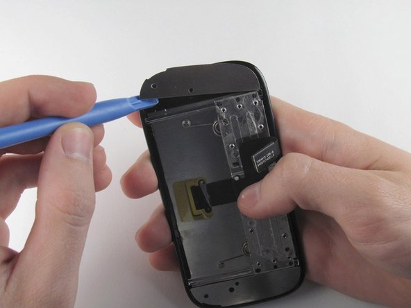

    • Wedge a plastic opening tool underneath one of the metal panels on the underside of the display assembly.
    • Pry upwards and remove the metal panel.
    • Repeat this step for the second metal panel located on the opposite side of the phone.

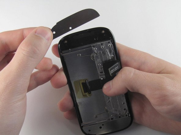

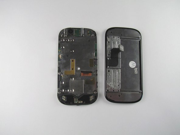

  16. Disassembling Motorola Cliq LCD Shield Plate: crwdns2935265:016crwdnd2935265:01crwdnd2935265:01crwdne2935265:0
    • Remove the four 3.0 mm T4 Torx screws at the corners of the phone.

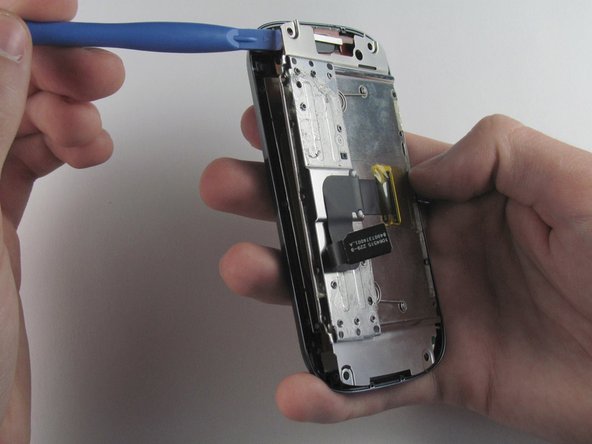

  17. Disassembling Motorola Cliq LCD Shield Plate: crwdns2935265:017crwdnd2935265:01crwdnd2935265:03crwdne2935265:0 Disassembling Motorola Cliq LCD Shield Plate: crwdns2935265:017crwdnd2935265:02crwdnd2935265:03crwdne2935265:0 Disassembling Motorola Cliq LCD Shield Plate: crwdns2935265:017crwdnd2935265:03crwdnd2935265:03crwdne2935265:0

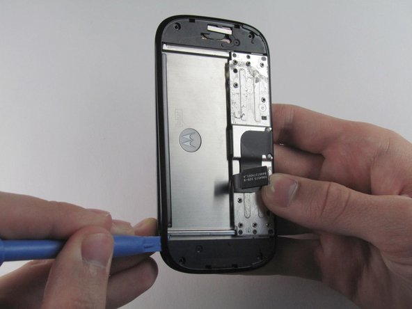

    • Wedge a plastic opening tool between the edge and the black pastic cover on the underside of the display assembly.
    • Run the plastic opening tool along the edges to separate the black plastic cover from the display assembly.
    • Remove the black plastic cover.
  18. Disassembling Motorola Cliq LCD Shield Plate: crwdns2935265:018crwdnd2935265:01crwdnd2935265:01crwdne2935265:0
    • Remove the six 3.0 mm T4 Torx screws that align on the phone's sides.

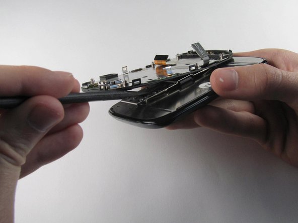

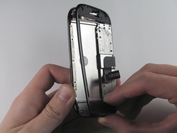

  19. Disassembling Motorola Cliq LCD Shield Plate: crwdns2935265:019crwdnd2935265:01crwdnd2935265:02crwdne2935265:0 Disassembling Motorola Cliq LCD Shield Plate: crwdns2935265:019crwdnd2935265:02crwdnd2935265:02crwdne2935265:0
    • Insert a plastic opening tool between the LCD shield plate and a corner of the keyboard slider plate.
    • Pry apart the keyboard slider plate and LCD shield plate.
    • Do not completely separate them: the keyboard slider plate is still connected to the LCD shield plate via the display flex cable.
  20. Disassembling Motorola Cliq LCD Shield Plate: crwdns2935265:020crwdnd2935265:01crwdnd2935265:02crwdne2935265:0 Disassembling Motorola Cliq LCD Shield Plate: crwdns2935265:020crwdnd2935265:02crwdnd2935265:02crwdne2935265:0
    • Pry the display flex cable from its connector on the LCD shield plate with a plastic opening tool.
    • Separate the display flex cable from the LCD cover plate.
