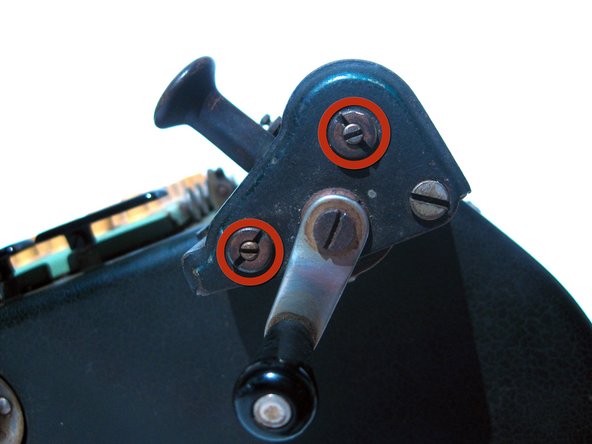

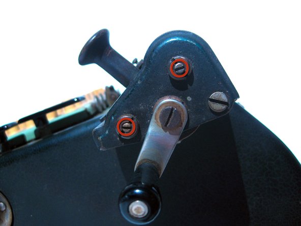

    • The carriage has a row of 8 digits above, which is the counter, and a row of 16 digits below, which is the accumulator. Let's remove it.
    • Take two screwdrivers, and unscrew, simultaneously, the screw heads indicated on either side of the carriage.
    • The left screw head is attached to a screw, while the right one is just a head attached to a shaft.
    • 4-48 machine screw, 1/4"
    • Carriage shaft, 0.249" diameter
    • Use an awl to poke the shaft from the left side so that it comes out the right side. Pull the shaft out completely.
    • Pull back the carriage hook arms and lift the carriage off.

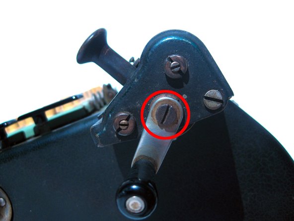

  4. Disassembling Monroe LA5-160 calculator completely: crwdns2935265:04crwdnd2935265:01crwdnd2935265:02crwdne2935265:0 Disassembling Monroe LA5-160 calculator completely: crwdns2935265:04crwdnd2935265:02crwdnd2935265:02crwdne2935265:0
    • Turning the zeroing crank counterclockwise sets the counter digits to zero, while turning it clockwise sets the accumulator digits to zero. Amazing!
    • Nelson White's U.S. patent "Zero-setting mechanism", filed in 1920, describes how this amazing thing works.
    • This amazing thing practically never works properly after half a century of neglect.
    • On the right side of the carriage, unscrew and remove the zeroing crank. Hold the crank while unscrewing.
    • Zeroing crank

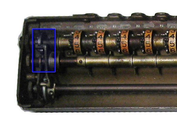

  7. Disassembling Monroe LA5-160 calculator completely: crwdns2935265:07crwdnd2935265:01crwdnd2935265:01crwdne2935265:0
    • Remove the cam lock arm spring from the left side of the carriage.
    • Extension spring, OD 0.123", WD 0.014", compressed length 0.34"
    • This spring pulls the arms against cams fixed to the digit shafts so that the digit shafts will not rotate when the zero-setting mechanism is not operating. It is important that the digit shafts themselves not rotate, since each digit wheel needs to be able to rotate freely on the shaft.

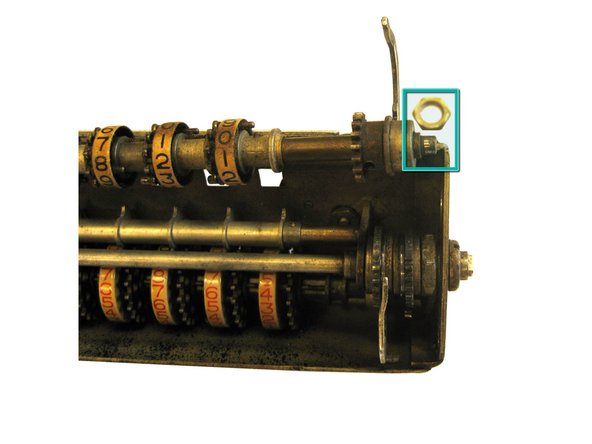

  8. Disassembling Monroe LA5-160 calculator completely: crwdns2935265:08crwdnd2935265:01crwdnd2935265:03crwdne2935265:0 Disassembling Monroe LA5-160 calculator completely: crwdns2935265:08crwdnd2935265:02crwdnd2935265:03crwdne2935265:0 Disassembling Monroe LA5-160 calculator completely: crwdns2935265:08crwdnd2935265:03crwdnd2935265:03crwdne2935265:0
    • Swing the two lock arms that the spring was holding together up and out of the way.
    • Push the accumulator shaft to the left until you can pull up on the right side. The nut that held the shaft's bushing should be free to remove.
    • 1/4-32 panel nut, width 5/16", height 5/64"
    • There is a cam lever on the middle shaft. Pull up on the part of it that rests on the cam attached to the left side of the accumulator shaft. You should be able to fully remove the accumulator shaft.
    • Lifting the cam lever rotates the middle zeroing shaft so that its zeroing teeth move closer to the accumulator shaft. When the accumulator shaft rotates, each digit wheel has a projection that hits up against the zeroing tooth, conveniently stopping that digit wheel at zero.
