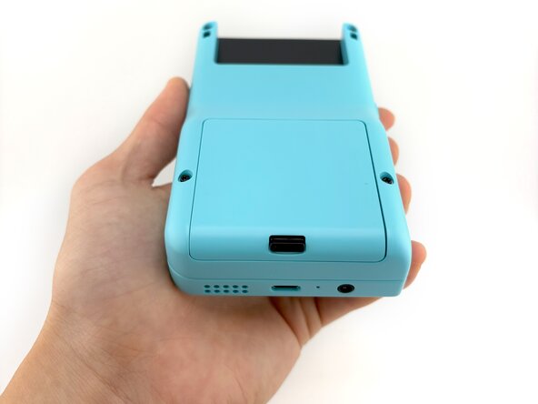

      • To remove the battery cover, push upward on the battery cover lock. The battery cover will pop open.
      • Lift the battery cover off and set aside.
      • Remove the batteries.
      • Always remove the batteries before working on your Chromatic!

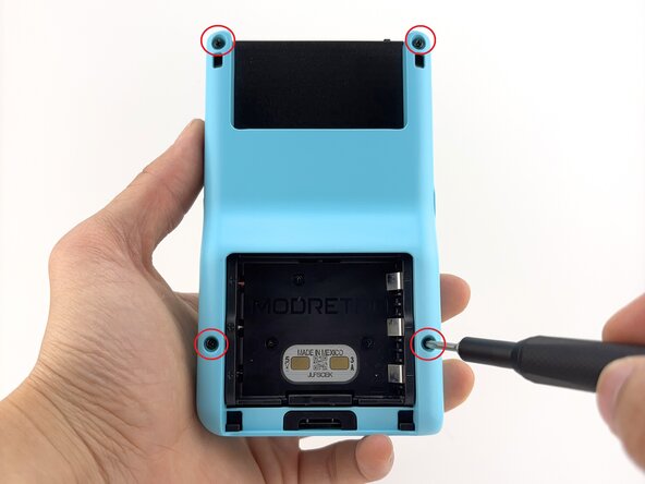

    2. Disassembling ModRetro Chromatic (Released Mid-2025), Back Shell: crwdns2935265:02crwdnd2935265:01crwdnd2935265:03crwdne2935265:0 Disassembling ModRetro Chromatic (Released Mid-2025), Back Shell: crwdns2935265:02crwdnd2935265:02crwdnd2935265:03crwdne2935265:0 Disassembling ModRetro Chromatic (Released Mid-2025), Back Shell: crwdns2935265:02crwdnd2935265:03crwdnd2935265:03crwdne2935265:0
      • Remove the back shell screws (x4) using a Tri-wing Y1 Screwdriver.
      • A Tri-wing Y1.5 will also work for all screws.
      • The screws near the top are a different length than the screws near the bottom of the shell.
      • Remove the back shell by lifting away from the device.
