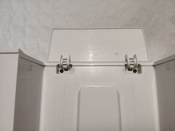

  1. Disassembling Miele CM7 Coffee Maker Unit case, Water tank side: crwdns2935265:01crwdnd2935265:01crwdnd2935265:02crwdne2935265:0 Disassembling Miele CM7 Coffee Maker Unit case, Water tank side: crwdns2935265:01crwdnd2935265:02crwdnd2935265:02crwdne2935265:0
    • Remove the cover by simply pulling it.
    • Unscrew 2 screws (T10).

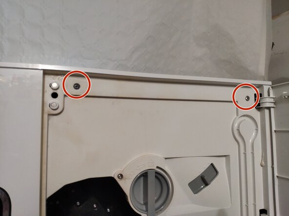

  2. Disassembling Miele CM7 Coffee Maker Unit case, Brewing unit side: crwdns2935265:02crwdnd2935265:01crwdnd2935265:01crwdne2935265:0
