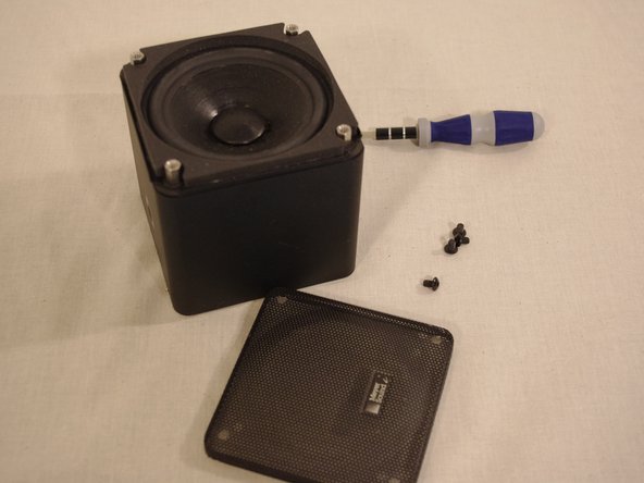

    • Turn the speaker face down, so the connector side is up.
    • Remove the four #2 Philips screws on the back plate.
  2. Disassembling Meyer Sound MM-4 Ultra Compact Wide-Range Loudspeaker Case: crwdns2935265:02crwdnd2935265:01crwdnd2935265:01crwdne2935265:0
    • Remove the foam insert to expose the two spade connectors.
    • Carefully separate the connectors
  3. Disassembling Meyer Sound MM-4 Ultra Compact Wide-Range Loudspeaker Case: crwdns2935265:03crwdnd2935265:01crwdnd2935265:02crwdne2935265:0 Disassembling Meyer Sound MM-4 Ultra Compact Wide-Range Loudspeaker Case: crwdns2935265:03crwdnd2935265:02crwdnd2935265:02crwdne2935265:0
    • Turn the speaker so the grill side is up.
    • Remove the four screws on the grill. I had to use a t-10 Torx bit to remove them.
    • The grill is not glued on, but may require a bit of prying to remove.
  4. Disassembling Meyer Sound MM-4 Ultra Compact Wide-Range Loudspeaker Case: crwdns2935265:04crwdnd2935265:01crwdnd2935265:02crwdne2935265:0 Disassembling Meyer Sound MM-4 Ultra Compact Wide-Range Loudspeaker Case: crwdns2935265:04crwdnd2935265:02crwdnd2935265:02crwdne2935265:0
    • Remove the four silver bolts holding the speaker in place. These bolts also have threads inset for the grill screws to fit into.
    • This is a pretty quick and easy teardown, not too many parts in this one. The meyer speaker's part number is ST-164. It's a 16 Ohm driver.

So I took one of my MM-4 apart because something was rattling. Turns out it has a loose magnet assembly. It must have been dropped in shipping.
