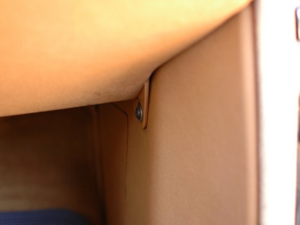

    • Begin by gently prying out the covers for the screws on the upper edge of the kick panel.
  2. Disassembling Mercedes W123 Kick Panel: crwdns2935265:02crwdnd2935265:01crwdnd2935265:01crwdne2935265:0
    • Then remove these screws.

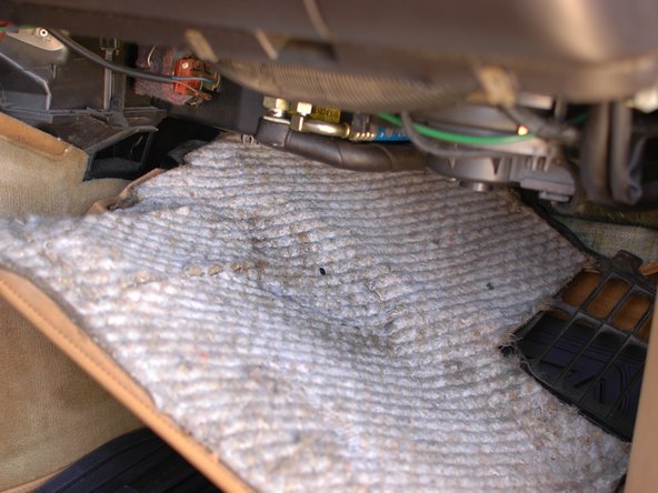

    • Now lower the panel down and rest if on the floor.
    • It can be removed full for further ease of access, depending on the job at hand.
  5. Disassembling Mercedes W123 Kick Panel: crwdns2935265:05crwdnd2935265:01crwdnd2935265:03crwdne2935265:0 Disassembling Mercedes W123 Kick Panel: crwdns2935265:05crwdnd2935265:02crwdnd2935265:03crwdne2935265:0 Disassembling Mercedes W123 Kick Panel: crwdns2935265:05crwdnd2935265:03crwdnd2935265:03crwdne2935265:0
    • Now you'll want to identify some of the components you are looking at so you can begin working on the one that is having issues.
    • Here are some of the ones you may find. This car is a 1985 300D; if you have an older model the items are likely a bit different.

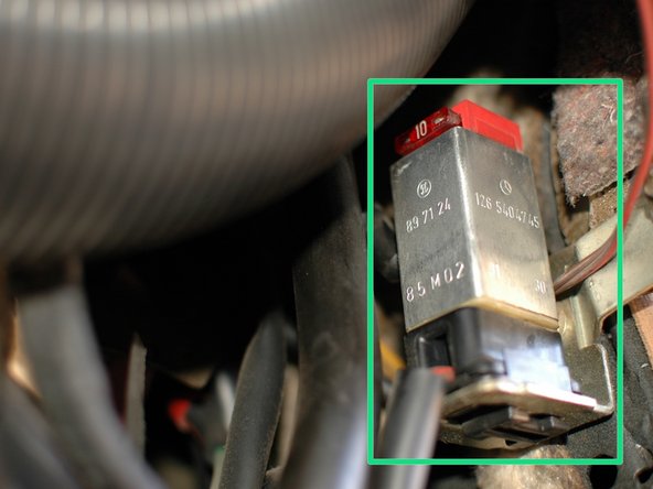

    • Over-voltage protection relay

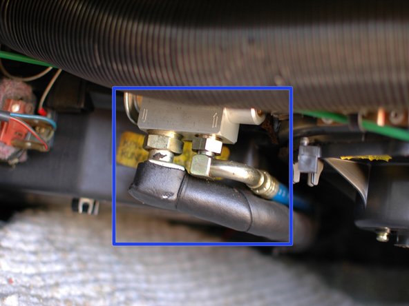

    • Air-conditioning expansion valve
