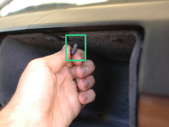

    • Gently pry apart the expansion plug in the glove box clips. There will be a row of them on top, and on the bottom.
    • Once you've pried it out part of the way you can pull it the rest of the way out by hand, or gently with needle nose pliers.
  4. Disassembling Mercedes W123 Glove Box Liner: crwdns2935265:04crwdnd2935265:01crwdnd2935265:01crwdne2935265:0
    • You can then pry the clips out of the liner. Remove them all.
