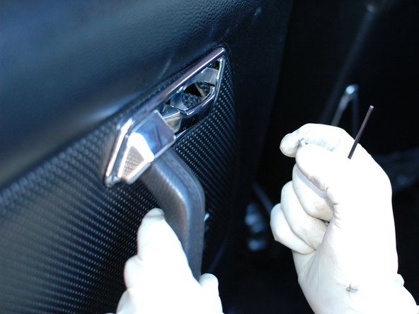

    • Remove the screw that holds the chrome plate behind the door pull.
    • Once again, the 2.5mm allen screw shown is not original. This will normally be a Phillips screw.
    • On the driver's side door, with no upper section of the arm on the door panel, the chrome panel behind the door pull can simply be removed and set aside at this point.

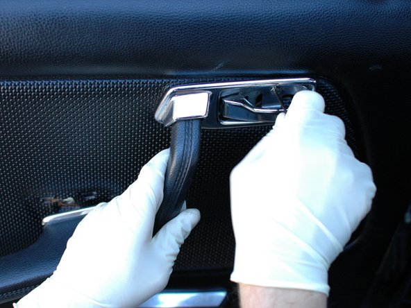

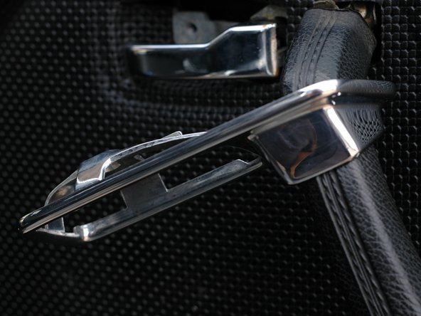

    • On the other three doors, the chrome panel is a part of the upper arm on the door panel. Pull the chrome panel out from behind the door pull. You will need to pull the door pull away from the door to get the chrome panel around it. It will move down the arm on the door panel.

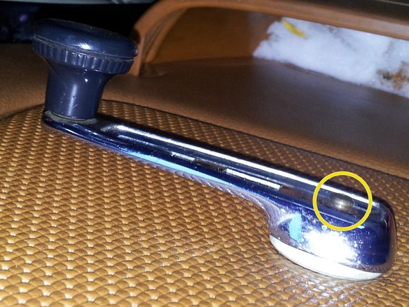

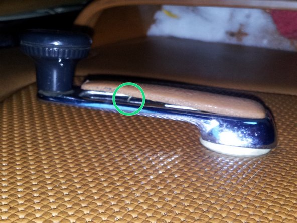

    • For doors with manual windows, you will need to remove the crank before removing the panel.
    • Use a finger to push the tab that holds the trim piece to the crank out until it clears the crank.
    • Pull trim toward the knob on the crank to release the trim.
    • The trim piece will release from the peg at the base of the crank. The crank will now slide off.
    • When reassembling the manual window crank, make sure the tapered end of the washer is facing away from the door.
    • The tapered washer is sometimes missing. It is used to protect the panel from wear.

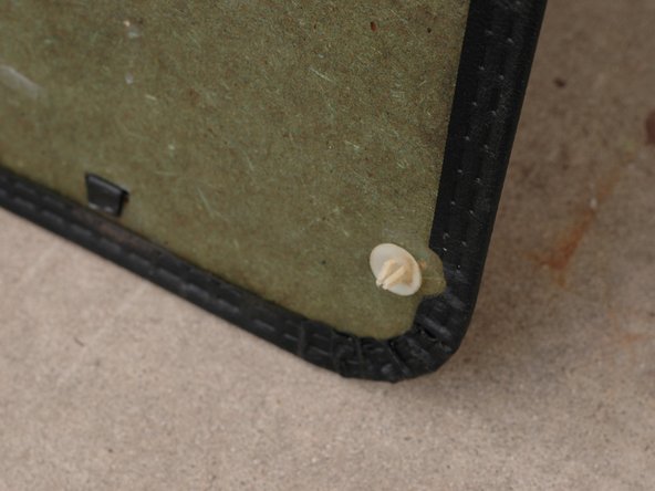

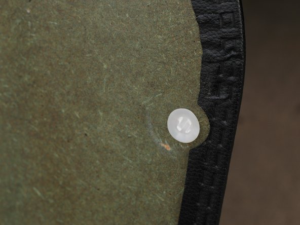

    • Pictured is the back of your door panel once removed. Notice the white plastic clips around the edge. Notice that many are missing. There should be several more on this door. Also, notice that some are broken.

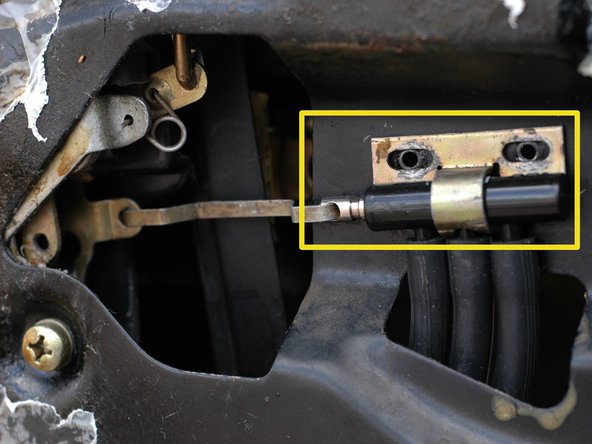

    • Door lock vacuum actuator, early style (does not apply to driver's door, which is equipped with the master vacuum switch instead, see attached picture). On later W123's, the actuators are in similar locations but look different.
    • Door pull
    • Door latch and lock mechanisms
    • Master vacuum switch (driver's door). Note that on later models the master switch will be oriented vertically instead of horizontally.
