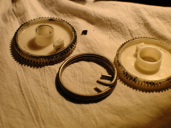

  12. Disassembling Mercedes W123 Antenna Motor: crwdns2935265:012crwdnd2935265:01crwdnd2935265:02crwdne2935265:0 Disassembling Mercedes W123 Antenna Motor: crwdns2935265:012crwdnd2935265:02crwdnd2935265:02crwdne2935265:0
    • The gears can be separated by simply pulling them apart with your hands.
    • Make note of which gear is the upper gear, and of the alignment of the gears and the spring together.
