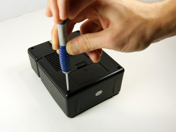

    • Use the long, skinny phillips head screwdriver to remove the 4 7/16" screws on the back of the device in the four corners.
    • Once unscrewed, do not try to take each screw out. Move to next step once all screwed have been unscrewed.

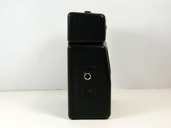

    • Use a 9/16" socket to remove the nut around the headphone jack. Be careful to not lose the washer.
  6. Disassembling Marshall MS-2 Partner Circuit Board: crwdns2935265:06crwdnd2935265:01crwdnd2935265:01crwdne2935265:0
    • Remove the 7/16" phillips head screw.
  7. Disassembling Marshall MS-2 Partner Circuit Board: crwdns2935265:07crwdnd2935265:01crwdnd2935265:01crwdne2935265:0
    • Grab the headphone jack from inside the case and pull it toward the speaker until you can fully remove it from the device.
