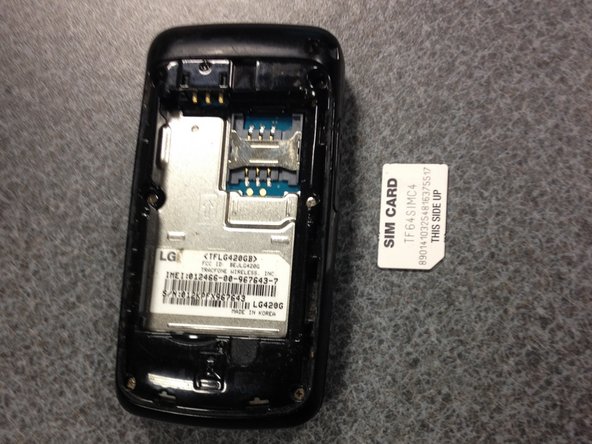

  2. Disassembling LG420G Entire Phone: crwdns2935265:02crwdnd2935265:01crwdnd2935265:02crwdne2935265:0 Disassembling LG420G Entire Phone: crwdns2935265:02crwdnd2935265:02crwdnd2935265:02crwdne2935265:0
    • Apply light pressure to the area shown and pull out gently to remove the SIM card.

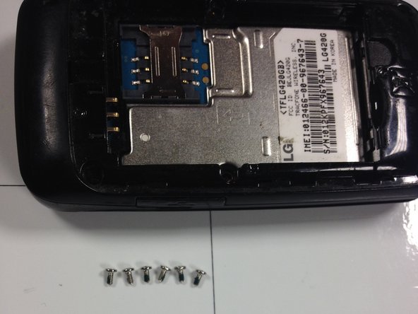

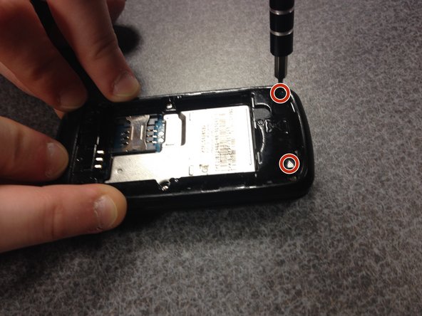

  3. Disassembling LG420G Entire Phone: crwdns2935265:03crwdnd2935265:01crwdnd2935265:03crwdne2935265:0 Disassembling LG420G Entire Phone: crwdns2935265:03crwdnd2935265:02crwdnd2935265:03crwdne2935265:0 Disassembling LG420G Entire Phone: crwdns2935265:03crwdnd2935265:03crwdnd2935265:03crwdne2935265:0
    • Using a Phillips #000 screwdriver, remove all six screws.

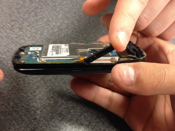

  4. Disassembling LG420G Entire Phone: crwdns2935265:04crwdnd2935265:01crwdnd2935265:01crwdne2935265:0
    • With your tweezers, gently pry around the sides to expose the circuitry.
  5. Disassembling LG420G Entire Phone: crwdns2935265:05crwdnd2935265:01crwdnd2935265:01crwdne2935265:0
    • Separate the plastic shells gently and place both now exposed pieces on the ground.

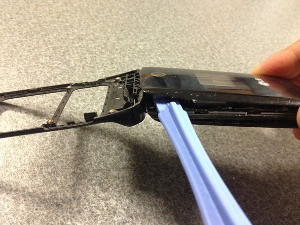

  9. Disassembling LG420G Entire Phone: crwdns2935265:09crwdnd2935265:01crwdnd2935265:02crwdne2935265:0 Disassembling LG420G Entire Phone: crwdns2935265:09crwdnd2935265:02crwdnd2935265:02crwdne2935265:0
    • With an opening tool, start opening the front face of the phone.
  10. Disassembling LG420G Entire Phone: crwdns2935265:010crwdnd2935265:01crwdnd2935265:01crwdne2935265:0
    • Gently remove the front cover to further expose electronics inside.
