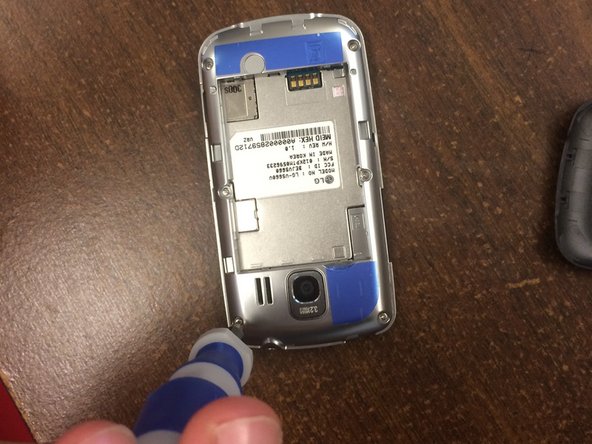

  4. Disassembling LG Vortex, Unscrew the Back Frame: crwdns2935265:04crwdnd2935265:01crwdnd2935265:02crwdne2935265:0 Disassembling LG Vortex, Unscrew the Back Frame: crwdns2935265:04crwdnd2935265:02crwdnd2935265:02crwdne2935265:0
    • All screws are the same size screwdriver head #00
    • Use the precision screwdriver to remove the 6 screws along the edges of the phone.
    • There are 2 screws at the top in each corner, 2 in the middle on the sides, and 2 in the bottom corners.
    • Place the screws in a container to ensure they aren't lost.

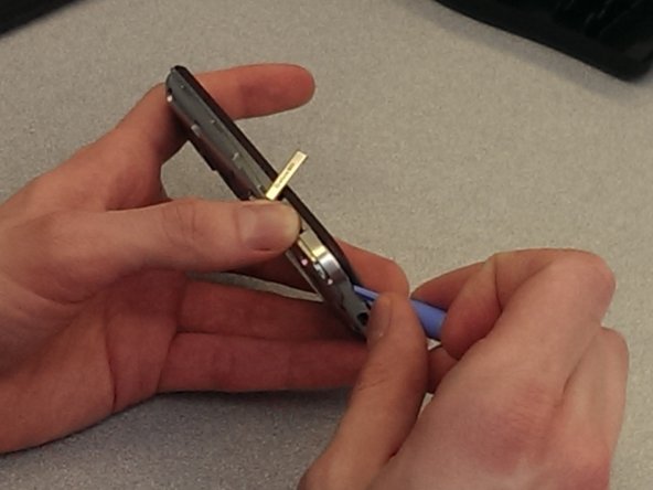

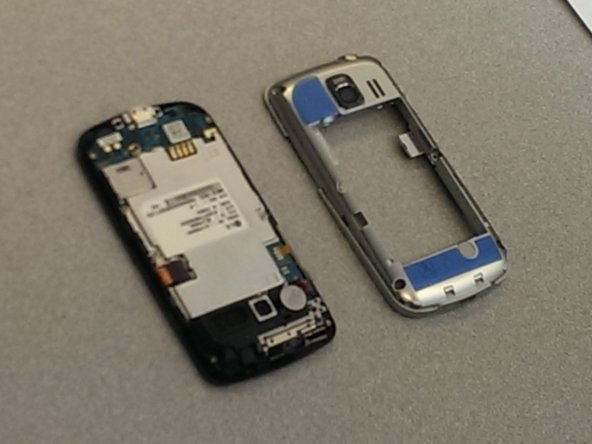

  5. Disassembling LG Vortex, Remove the Back Frame: crwdns2935265:05crwdnd2935265:01crwdnd2935265:03crwdne2935265:0 Disassembling LG Vortex, Remove the Back Frame: crwdns2935265:05crwdnd2935265:02crwdnd2935265:03crwdne2935265:0 Disassembling LG Vortex, Remove the Back Frame: crwdns2935265:05crwdnd2935265:03crwdnd2935265:03crwdne2935265:0
    • Use the blue plastic opening tool to remove the back frame from the rest of the phone.
    • Pry at the micro SD slot. Push the cover for the SD slot away from the front of the phone and pry the back frame away from the rest of the phone.
    • Pry your way around the entire phone to separate the face from the frame.
