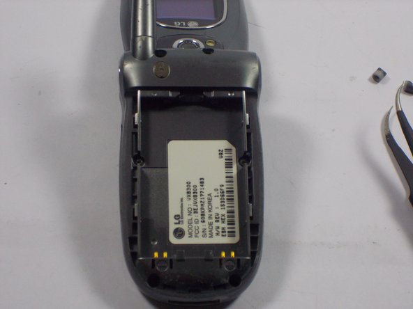

    • Remove the battery pack cover by pushing down on the solid lines at the top end of the cover. Slide the cover down while applying the pushing force at the top to remove the cover completely.
  2. Disassembling LG VX8300 Body: crwdns2935265:02crwdnd2935265:01crwdnd2935265:02crwdne2935265:0 Disassembling LG VX8300 Body: crwdns2935265:02crwdnd2935265:02crwdnd2935265:02crwdne2935265:0

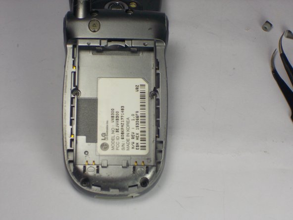

    • Place your finger into the semicircle gap on top of the battery.
    • Apply force downward and out, so the battery pops out of the phone.

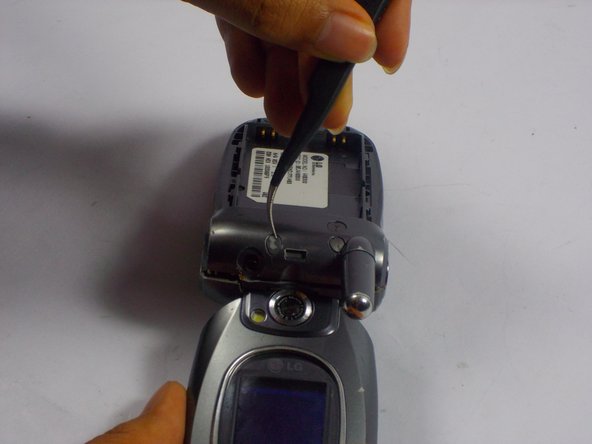

    • Locate the two rubber pads covering the screws at the top of the phone near the hinge.
    • Use tweezers to lift and remove the rubber pads.

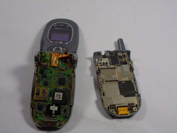

  5. Disassembling LG VX8300 Body: crwdns2935265:05crwdnd2935265:01crwdnd2935265:02crwdne2935265:0 Disassembling LG VX8300 Body: crwdns2935265:05crwdnd2935265:02crwdnd2935265:02crwdne2935265:0
    • Use your fingers to gently separate the front plate from the phone. You may need to slide a plastic opening tool along the crevice between the faces to separate it more easily.
    • Remove the casing after it has been detached. The logic board is now fully accessible.
    • Once the body case is removed, the volume and camera buttons move freely. Ensure all loose pieces remain accounted for.
