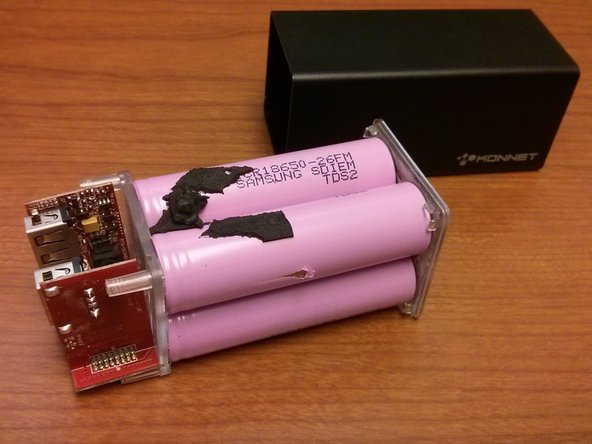

Disassembling Konnet PowerEZ Pro External Battery
  1. Disassembling Konnet PowerEZ Pro External Battery, External Rechargable Battery: crwdns2935265:01crwdnd2935265:01crwdnd2935265:02crwdne2935265:0 Disassembling Konnet PowerEZ Pro External Battery, External Rechargable Battery: crwdns2935265:01crwdnd2935265:02crwdnd2935265:02crwdne2935265:0
    • Take a small flat screwdriver or any plastic opening tool and start to remove the silver cover.
    • The backing has lots of double sided tape to hold this down so some force will be required.
  2. Disassembling Konnet PowerEZ Pro External Battery: crwdns2935265:02crwdnd2935265:01crwdnd2935265:02crwdne2935265:0 Disassembling Konnet PowerEZ Pro External Battery: crwdns2935265:02crwdnd2935265:02crwdnd2935265:02crwdne2935265:0
    • Remove 4 Philips screws to release the plastic cover
  3. Disassembling Konnet PowerEZ Pro External Battery: crwdns2935265:03crwdnd2935265:01crwdnd2935265:02crwdne2935265:0 Disassembling Konnet PowerEZ Pro External Battery: crwdns2935265:03crwdnd2935265:02crwdnd2935265:02crwdne2935265:0
    • Carefully push from the side you just opened. All the inside parts should slide out from the back of the unit.
