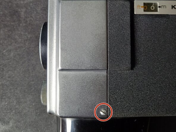

    1. Disassembling Konica Compact 8 Front Cover, Left side screw: crwdns2935265:01crwdnd2935265:01crwdnd2935265:01crwdne2935265:0
      • Remove the screw on the left side if the camera is facing your way.

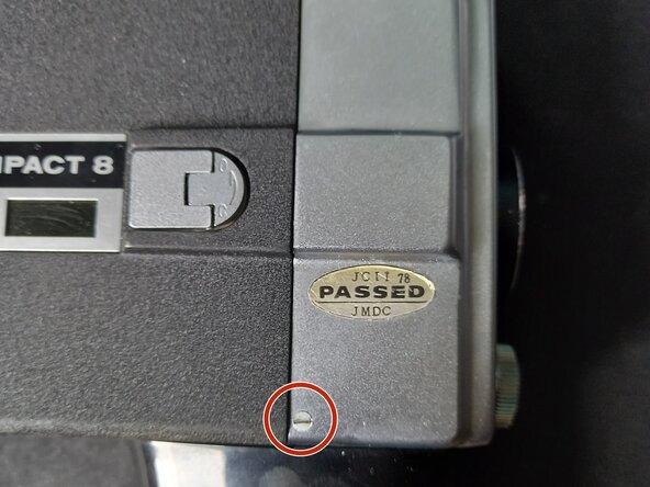

    2. Disassembling Konica Compact 8 Front Cover, Right side screw: crwdns2935265:02crwdnd2935265:01crwdnd2935265:01crwdne2935265:0
      • Remove the screw on the right side if the camera is facing you.
