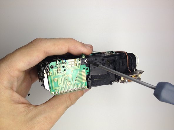

    4. Disassembling Kodak Advantix F350 View Finder: crwdns2935265:020crwdnd2935265:01crwdnd2935265:01crwdne2935265:0
      • Locate the 2 screws on the top of the camera.
      • These are holding the view finder assembly in place.
    5. Disassembling Kodak Advantix F350 View Finder: crwdns2935265:021crwdnd2935265:01crwdnd2935265:02crwdne2935265:0 Disassembling Kodak Advantix F350 View Finder: crwdns2935265:021crwdnd2935265:02crwdnd2935265:02crwdne2935265:0
      • Use the Phillips #00 Precision Screwdriver to remove the screws.
    6. Disassembling Kodak Advantix F350 View Finder: crwdns2935265:022crwdnd2935265:01crwdnd2935265:02crwdne2935265:0 Disassembling Kodak Advantix F350 View Finder: crwdns2935265:022crwdnd2935265:02crwdnd2935265:02crwdne2935265:0

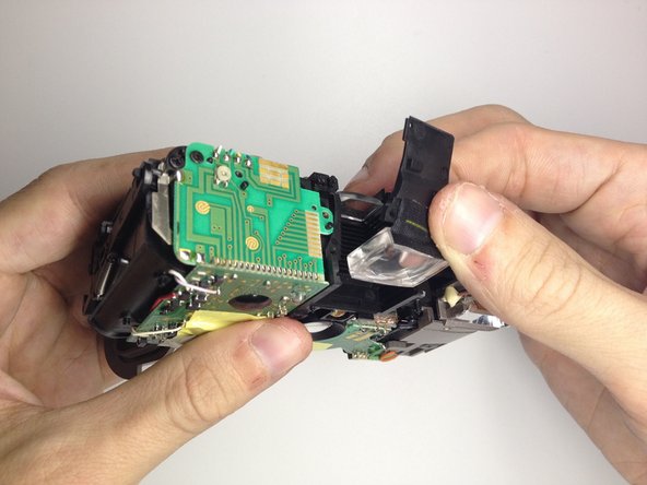

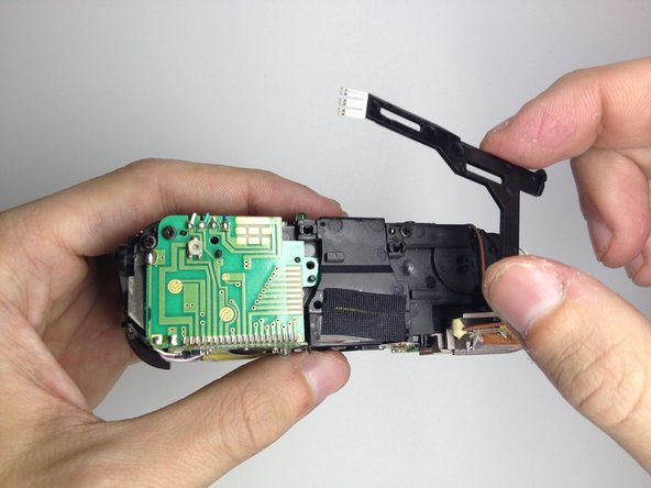

      • Remove the mount holding the view finder in place.
    7. Disassembling Kodak Advantix F350 View Finder: crwdns2935265:023crwdnd2935265:01crwdnd2935265:02crwdne2935265:0 Disassembling Kodak Advantix F350 View Finder: crwdns2935265:023crwdnd2935265:02crwdnd2935265:02crwdne2935265:0
      • Remove the front view finder.
      • Gently fold the plastic up from the back.
      • Pull up to remove the front view finder.

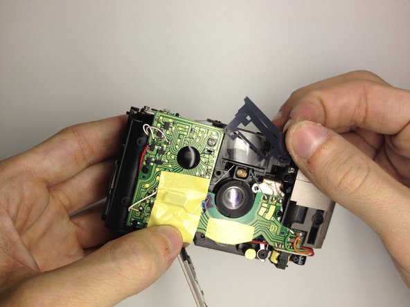

    8. Disassembling Kodak Advantix F350 View Finder: crwdns2935265:024crwdnd2935265:01crwdnd2935265:01crwdne2935265:0
      • Gently grab the back view finder.
      • Slide up to remove from camera.
