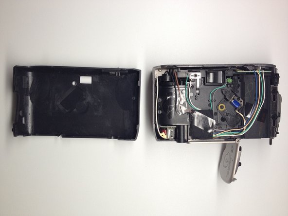

  3. Disassembling Kodak Advantix F350 Display: crwdns2935265:03crwdnd2935265:01crwdnd2935265:03crwdne2935265:0 Disassembling Kodak Advantix F350 Display: crwdns2935265:03crwdnd2935265:02crwdnd2935265:03crwdne2935265:0 Disassembling Kodak Advantix F350 Display: crwdns2935265:03crwdnd2935265:03crwdnd2935265:03crwdne2935265:0
    • Use the Phillips #00 Precision Screwdriver and remove the screws on the back cover.

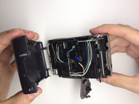

  4. Disassembling Kodak Advantix F350 Display: crwdns2935265:04crwdnd2935265:01crwdnd2935265:02crwdne2935265:0 Disassembling Kodak Advantix F350 Display: crwdns2935265:04crwdnd2935265:02crwdnd2935265:02crwdne2935265:0
    • Open the film door to remove the back cover.
    • Slide the film door lever to the left until the film door opens.
  5. Disassembling Kodak Advantix F350 Display: crwdns2935265:05crwdnd2935265:01crwdnd2935265:02crwdne2935265:0 Disassembling Kodak Advantix F350 Display: crwdns2935265:05crwdnd2935265:02crwdnd2935265:02crwdne2935265:0
    • Use a plastic opening tool to pry the case open until a small gap is present.
    • Repeat this process at the top and bottom of the film door to loosen it.
  6. Disassembling Kodak Advantix F350 Display: crwdns2935265:06crwdnd2935265:01crwdnd2935265:03crwdne2935265:0 Disassembling Kodak Advantix F350 Display: crwdns2935265:06crwdnd2935265:02crwdnd2935265:03crwdne2935265:0 Disassembling Kodak Advantix F350 Display: crwdns2935265:06crwdnd2935265:03crwdnd2935265:03crwdne2935265:0
    • Grab the top and bottom of the case firmly as shown.
    • Gently remove the back of the camera case with a slight twisting motion.

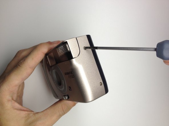

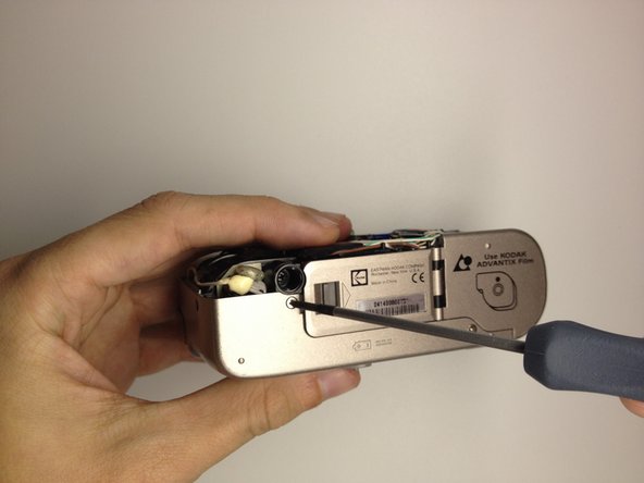

  7. Disassembling Kodak Advantix F350 Display, Front Cover: crwdns2935265:07crwdnd2935265:01crwdnd2935265:02crwdne2935265:0 Disassembling Kodak Advantix F350 Display, Front Cover: crwdns2935265:07crwdnd2935265:02crwdnd2935265:02crwdne2935265:0

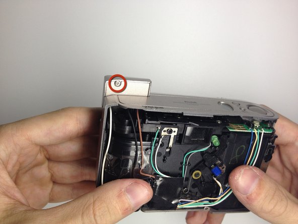

    • Locate the 3 screws on the camera that hold the front cover of the camera to the camera body.
    • The first 2 are located on the bottom of the camera.
    • The last screw is located behind the flash module.
    • Turn the camera on, and raise the flash module to locate the flash module screw.
  8. Disassembling Kodak Advantix F350 Display: crwdns2935265:08crwdnd2935265:01crwdnd2935265:02crwdne2935265:0 Disassembling Kodak Advantix F350 Display: crwdns2935265:08crwdnd2935265:02crwdnd2935265:02crwdne2935265:0

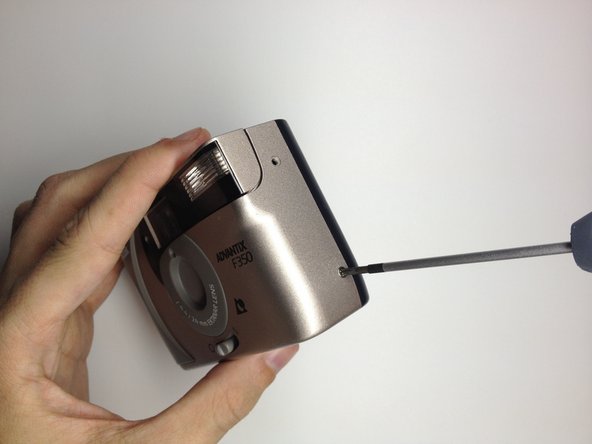

    • Remove the 2 screws at the base of the camera housing.
    • Use the Phillips #00 Precision Screwdriver and remove the screws.
    • Repeat this process for the screw behind the flash module.

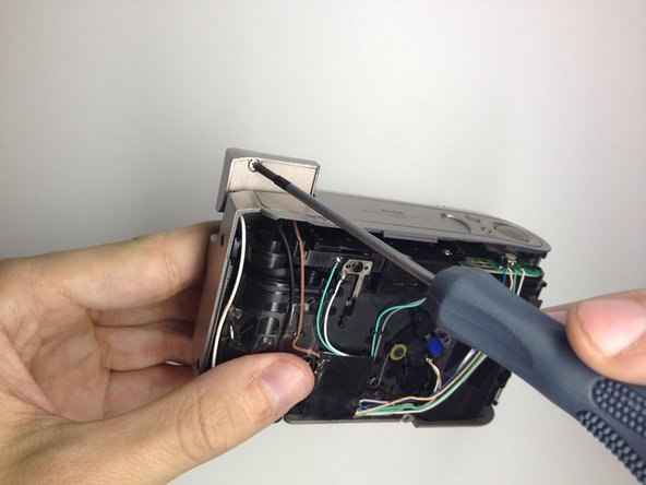

  9. Disassembling Kodak Advantix F350 Display: crwdns2935265:09crwdnd2935265:01crwdnd2935265:02crwdne2935265:0 Disassembling Kodak Advantix F350 Display: crwdns2935265:09crwdnd2935265:02crwdnd2935265:02crwdne2935265:0
    • Remove the screw located under the flash module using the Phillips #00 Precision Screwdriver.
  10. Disassembling Kodak Advantix F350 Display: crwdns2935265:010crwdnd2935265:01crwdnd2935265:02crwdne2935265:0 Disassembling Kodak Advantix F350 Display: crwdns2935265:010crwdnd2935265:02crwdnd2935265:02crwdne2935265:0

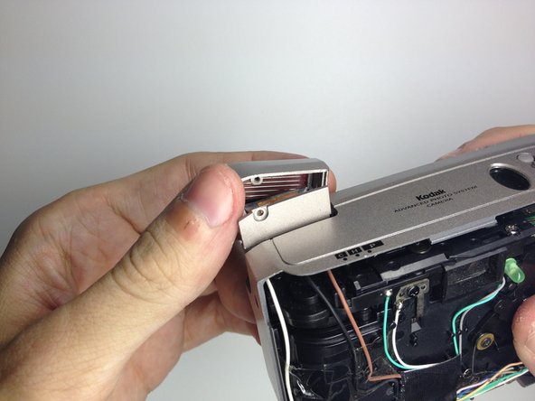

    • Remove the flash cover.
    • Remove the flash module by twisting it up and outward of the camera housing.
    • The cover can now be be removed.

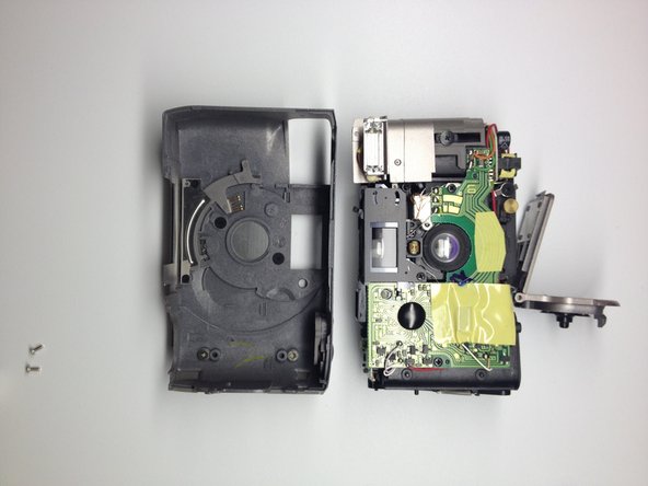

  11. Disassembling Kodak Advantix F350 Display: crwdns2935265:011crwdnd2935265:01crwdnd2935265:02crwdne2935265:0 Disassembling Kodak Advantix F350 Display: crwdns2935265:011crwdnd2935265:02crwdnd2935265:02crwdne2935265:0

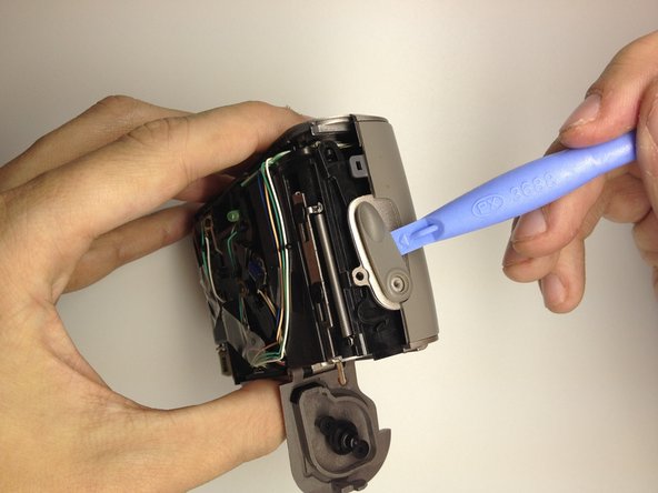

    • Remove the film door lever.
    • Remove the screw holding the film lever in place by using a Phillips #00 Precision Screwdriver.
    • Using a plastic opening tool, gently pry the switch upwards to remove it.

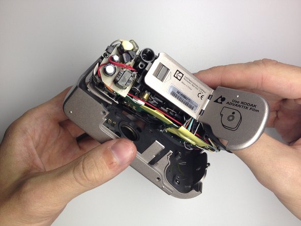

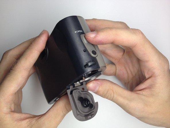

  12. Disassembling Kodak Advantix F350 Display: crwdns2935265:012crwdnd2935265:01crwdnd2935265:01crwdne2935265:0

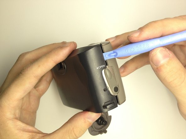

    • Open the battery door by pushing the lever towards the arrow indicated.
  13. Disassembling Kodak Advantix F350 Display: crwdns2935265:013crwdnd2935265:01crwdnd2935265:03crwdne2935265:0 Disassembling Kodak Advantix F350 Display: crwdns2935265:013crwdnd2935265:02crwdnd2935265:03crwdne2935265:0 Disassembling Kodak Advantix F350 Display: crwdns2935265:013crwdnd2935265:03crwdnd2935265:03crwdne2935265:0
    • Remove the front cover.
    • Insert your thumb in the film hole and gently pry the bottom loose.
    • Once the front is loose, gently pull it out.

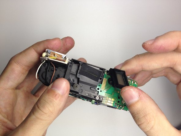

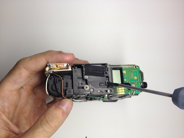

  14. Disassembling Kodak Advantix F350 Display, Display: crwdns2935265:014crwdnd2935265:01crwdnd2935265:01crwdne2935265:0
    • Locate the 3 screws on the top of the camera.
    • These will be removed in the next step.
  15. Disassembling Kodak Advantix F350 Display: crwdns2935265:015crwdnd2935265:01crwdnd2935265:03crwdne2935265:0 Disassembling Kodak Advantix F350 Display: crwdns2935265:015crwdnd2935265:02crwdnd2935265:03crwdne2935265:0 Disassembling Kodak Advantix F350 Display: crwdns2935265:015crwdnd2935265:03crwdnd2935265:03crwdne2935265:0
    • Remove the 3 screws using the Phillips #00 Precision Screwdriver.
  16. Disassembling Kodak Advantix F350 Display: crwdns2935265:016crwdnd2935265:01crwdnd2935265:02crwdne2935265:0 Disassembling Kodak Advantix F350 Display: crwdns2935265:016crwdnd2935265:02crwdnd2935265:02crwdne2935265:0

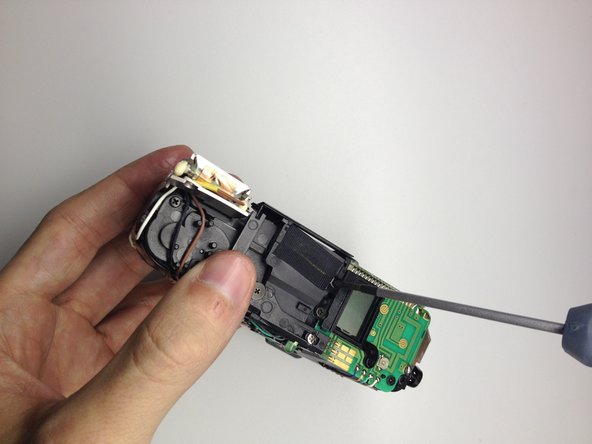

    • Remove the LCD.
    • Gently pry the LCD and plastic bezel upward with a plastic opening tool.
    • Remove LCD and replace as needed.
