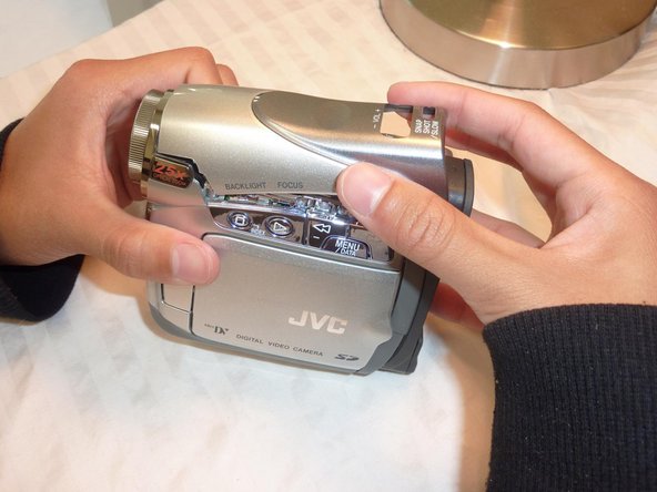

  5. Disassembling JVC GR-D290U: crwdns2935265:05crwdnd2935265:01crwdnd2935265:02crwdne2935265:0 Disassembling JVC GR-D290U: crwdns2935265:05crwdnd2935265:02crwdnd2935265:02crwdne2935265:0
    • Go to the side of the camera that has the LCD screen.
    • Place the plastic opening tool into the seam between the top cover and the bottom cover of the camera.
    • Pry the top cover from the bottom cover until you hear a snapping sound.
    • Gently remove the top cover from the camera base.
