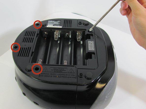

  3. Disassembling Insignia NS-B2110 Internal Components, Bottom Panel: crwdns2935265:03crwdnd2935265:01crwdnd2935265:01crwdne2935265:0
    • With a Phillips #2 screwdriver, remove two 2mm screws.
  4. Disassembling Insignia NS-B2110 Internal Components: crwdns2935265:04crwdnd2935265:01crwdnd2935265:02crwdne2935265:0 Disassembling Insignia NS-B2110 Internal Components: crwdns2935265:04crwdnd2935265:02crwdnd2935265:02crwdne2935265:0
    • Using a long Phillips #2 screwdriver, remove one 6mm screw located inside the battery compartment.
    • Use the same screwdriver to remove four more 6mm screws along the outside of the case.

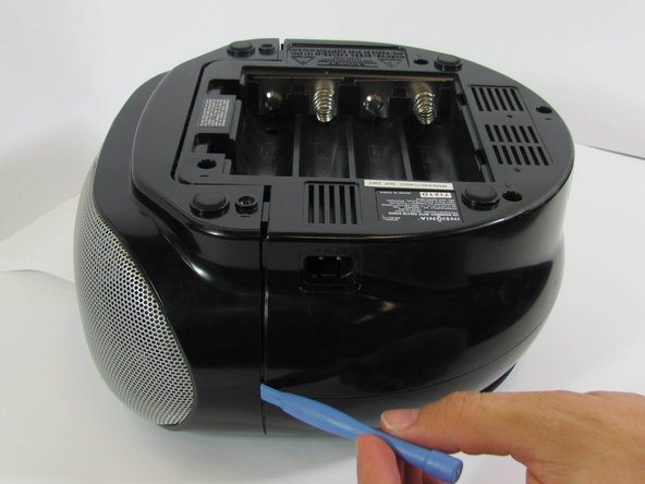

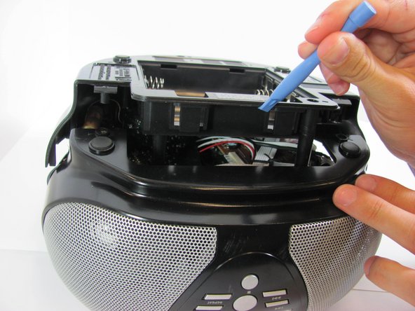

  5. Disassembling Insignia NS-B2110 Internal Components: crwdns2935265:05crwdnd2935265:01crwdnd2935265:03crwdne2935265:0 Disassembling Insignia NS-B2110 Internal Components: crwdns2935265:05crwdnd2935265:02crwdnd2935265:03crwdne2935265:0 Disassembling Insignia NS-B2110 Internal Components: crwdns2935265:05crwdnd2935265:03crwdnd2935265:03crwdne2935265:0
    • With a plastic opening tool, wedge the bottom shell from the main speaker face along the edge.
    • The bottom cover has two red and two yellow wires attached to it that you don't want to pull off. Handle the casing carefully.
    • Once the pieces are separated, pull them apart and place the bottom cover aside, near the stereo.

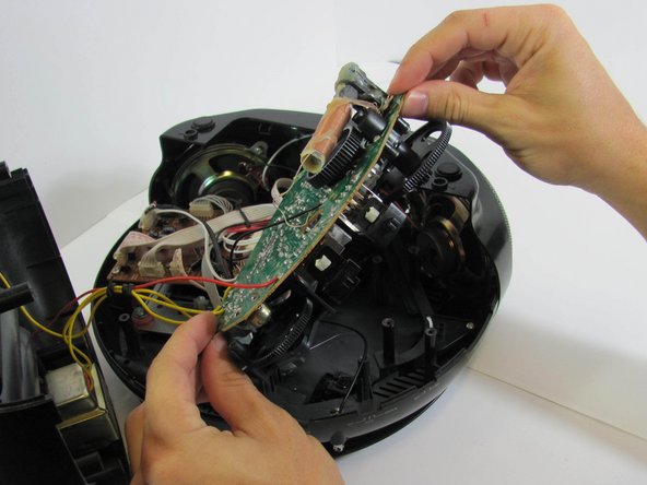

  6. Disassembling Insignia NS-B2110 Internal Components, Internal Components: crwdns2935265:06crwdnd2935265:01crwdnd2935265:02crwdne2935265:0 Disassembling Insignia NS-B2110 Internal Components, Internal Components: crwdns2935265:06crwdnd2935265:02crwdnd2935265:02crwdne2935265:0
    • With a Phillips #2 screwdriver, remove five 5mm screws from the "quarter circle" circuit board.
    • More wires! Handle the circuit board carefully and take caution not to stretch the red and white wires connected the board to the other components.
    • Remove the green quarter circle circuit board and place to the side.

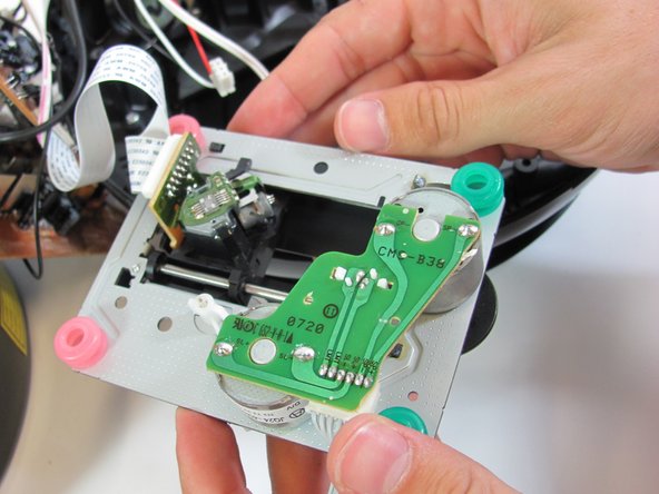

  12. Disassembling Insignia NS-B2110 Internal Components: crwdns2935265:012crwdnd2935265:01crwdnd2935265:02crwdne2935265:0 Disassembling Insignia NS-B2110 Internal Components: crwdns2935265:012crwdnd2935265:02crwdnd2935265:02crwdne2935265:0
    • With a Phillips #1 screwdriver, remove four 3mm screws from the silver metal circuit board.
    • This board has two white ribbons attached to it. Once again, be careful not to stretch these.
    • Remove and place the metal circuit board to the side.
