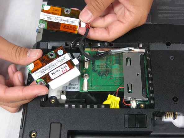

      • Turn the laptop over so the battery is facing you.
      • Locate the modem and ethernet card bay.
      • Remove the two 5.3mm cover screws.
      • Gently lift the cover.
    3. Disassembling IBM ThinkPad A30 Speakers: crwdns2935265:019crwdnd2935265:01crwdnd2935265:02crwdne2935265:0 Disassembling IBM ThinkPad A30 Speakers: crwdns2935265:019crwdnd2935265:02crwdnd2935265:02crwdne2935265:0
      • Remove the four 9.1mm screws attached to the modem and ethernet cards.
      • When lifting the cards, be careful not to rip out the cables!
      • Gently lift the modem and ethernet cards.

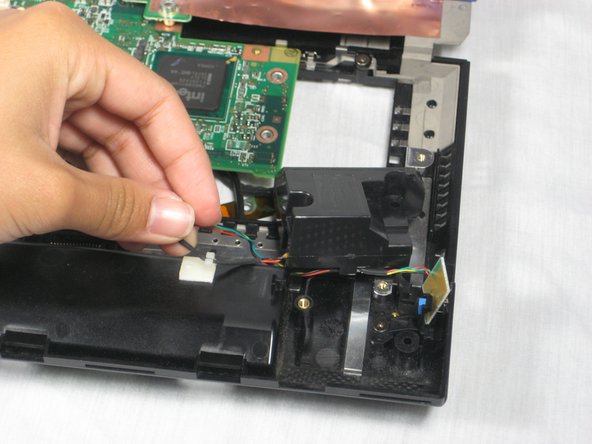

      • Locate the speakers on the bottom left and right of the ThinkPad A30.
    8. Disassembling IBM ThinkPad A30 Speakers: crwdns2935265:024crwdnd2935265:01crwdnd2935265:03crwdne2935265:0 Disassembling IBM ThinkPad A30 Speakers: crwdns2935265:024crwdnd2935265:02crwdnd2935265:03crwdne2935265:0 Disassembling IBM ThinkPad A30 Speakers: crwdns2935265:024crwdnd2935265:03crwdnd2935265:03crwdne2935265:0
      • Remove the 5.6mm screws on each speaker.
      • Pull the right speaker out, making sure there is still slack in the wire.
    9. Disassembling IBM ThinkPad A30 Speakers: crwdns2935265:025crwdnd2935265:01crwdnd2935265:02crwdne2935265:0 Disassembling IBM ThinkPad A30 Speakers: crwdns2935265:025crwdnd2935265:02crwdnd2935265:02crwdne2935265:0
      • Pull the blue tab that holds the speaker chip and pull the chip out.
    10. Disassembling IBM ThinkPad A30 Speakers: crwdns2935265:026crwdnd2935265:01crwdnd2935265:02crwdne2935265:0 Disassembling IBM ThinkPad A30 Speakers: crwdns2935265:026crwdnd2935265:02crwdnd2935265:02crwdne2935265:0
      • Remove the wires from the white tabs by lifting the black wire casing.
    11. Disassembling IBM ThinkPad A30 Speakers: crwdns2935265:027crwdnd2935265:01crwdnd2935265:02crwdne2935265:0 Disassembling IBM ThinkPad A30 Speakers: crwdns2935265:027crwdnd2935265:02crwdnd2935265:02crwdne2935265:0

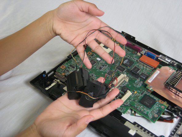

      • Lift the left speaker out.
    12. Disassembling IBM ThinkPad A30 Speakers: crwdns2935265:028crwdnd2935265:01crwdnd2935265:02crwdne2935265:0 Disassembling IBM ThinkPad A30 Speakers: crwdns2935265:028crwdnd2935265:02crwdnd2935265:02crwdne2935265:0
      • Remove the speaker data and power cables by pulling them from the motherboard.
      • You have successfully removed the ThinkPad A30 speakers.
