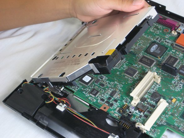

    7. Disassembling IBM ThinkPad A30 Motherboard: crwdns2935265:029crwdnd2935265:01crwdnd2935265:02crwdne2935265:0 Disassembling IBM ThinkPad A30 Motherboard: crwdns2935265:029crwdnd2935265:02crwdnd2935265:02crwdne2935265:0
      • Once the CD drive bay is removed, locate the speaker data and power cables.
      • Remove the cables from the motherboard.
    8. Disassembling IBM ThinkPad A30 Motherboard: crwdns2935265:030crwdnd2935265:01crwdnd2935265:02crwdne2935265:0 Disassembling IBM ThinkPad A30 Motherboard: crwdns2935265:030crwdnd2935265:02crwdnd2935265:02crwdne2935265:0
      • Locate the expansion bay.
      • Remove the 16mm screw.
      • Lift and remove the expansion bay.
