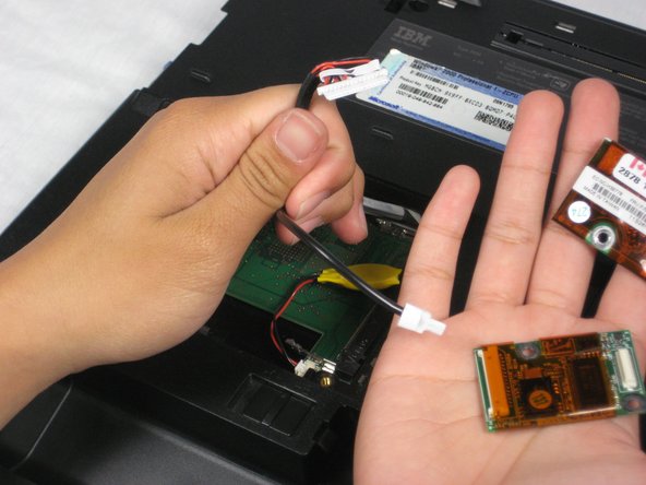

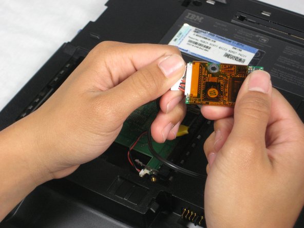

  3. Disassembling IBM ThinkPad A30 Modem and Ethernet Cards: crwdns2935265:03crwdnd2935265:01crwdnd2935265:01crwdne2935265:0
    • Remove the four 9.1mm screws attached to the ethernet and modem cards.
  4. Disassembling IBM ThinkPad A30 Modem and Ethernet Cards: crwdns2935265:04crwdnd2935265:01crwdnd2935265:03crwdne2935265:0 Disassembling IBM ThinkPad A30 Modem and Ethernet Cards: crwdns2935265:04crwdnd2935265:02crwdnd2935265:03crwdne2935265:0 Disassembling IBM ThinkPad A30 Modem and Ethernet Cards: crwdns2935265:04crwdnd2935265:03crwdnd2935265:03crwdne2935265:0
    • When lifting the cards, be careful not to rip out the cables!
    • Gently lift the modem and ethernet cards.
    • Remove the cables that attach the modem and ethernet cards.
