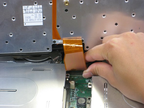

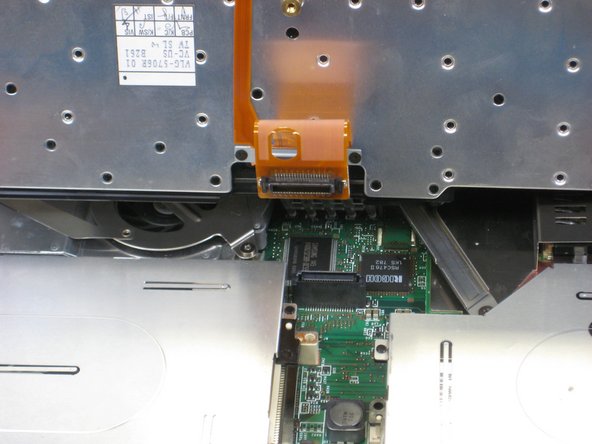

    5. Disassembling IBM ThinkPad A30 CPU: crwdns2935265:07crwdnd2935265:01crwdnd2935265:03crwdne2935265:0 Disassembling IBM ThinkPad A30 CPU: crwdns2935265:07crwdnd2935265:02crwdnd2935265:03crwdne2935265:0 Disassembling IBM ThinkPad A30 CPU: crwdns2935265:07crwdnd2935265:03crwdnd2935265:03crwdne2935265:0
      • Locate the connector attached to the motherboard.
      • Disconnect the ribbon cable by removing the connector.
    6. Disassembling IBM ThinkPad A30 CPU: crwdns2935265:08crwdnd2935265:01crwdnd2935265:02crwdne2935265:0 Disassembling IBM ThinkPad A30 CPU: crwdns2935265:08crwdnd2935265:02crwdnd2935265:02crwdne2935265:0
      • Lift and remove the keyboard.
