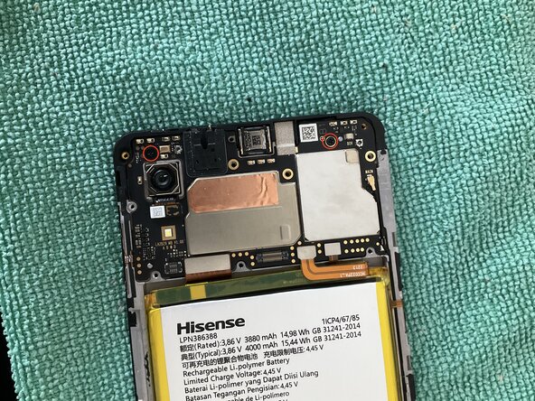

  5. Disassembling Hisense A9 screen and other parts: crwdns2935265:05crwdnd2935265:01crwdnd2935265:03crwdne2935265:0 Disassembling Hisense A9 screen and other parts: crwdns2935265:05crwdnd2935265:02crwdnd2935265:03crwdne2935265:0 Disassembling Hisense A9 screen and other parts: crwdns2935265:05crwdnd2935265:03crwdnd2935265:03crwdne2935265:0
    • Disconnect the antenna on both sides (upper board and lower board). Disconnect the ribbon cables on the upper board : camera cable, screen cable, battery and button cable.
    • Remove the 2 black screws that hold the upper board (one on each corner).
    • You should be able to remove the upper board. Proceed with caution, make sure anything that's in the way doesn't block it, like the camera ribbon cable for instance.

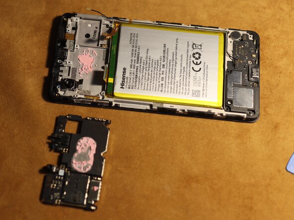

  6. Disassembling Hisense A9 screen and other parts: crwdns2935265:06crwdnd2935265:01crwdnd2935265:01crwdne2935265:0
    • Next comes the lower board. You should be able to remove it by wiggling it a little and you can use the USB port to lift it off gently from the case.
    • Remove the black screw that holds the loudspeaker. Notice that I didn't take it out, since my repair didn't require it. It has a connector that's stuck to the board, and should be easy to remove. Same goes for some of the buttons ribbon cables.
  7. Disassembling Hisense A9 screen and other parts: crwdns2935265:07crwdnd2935265:01crwdnd2935265:01crwdne2935265:0
    • Remove the battery, this is a bit painful to do. I've used dental floss to try to saw through it, and isopropyl alcohol to neutralize the glue. It'll take some time, and then you should be able to pry it out (remember not to bend or damage it, dangerous stuff).
