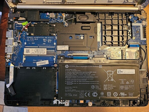

    • This is what the motherboard looks like after the bottom cover is removed.
    • Red is the RAM slot.
    • Green is the SATA drive location.
    • Yellow is the wireless card. Unplug the black cable. Unscrew the single screw.
    • The wireless card is Realtek RTL8723DE. HP P/N: 915618-003. Front is labeled AW-NB274NF.
