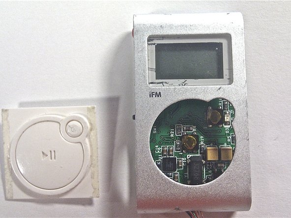

  5. Disassembling Griffin iFM 4027 LCD Screen Cover, Central Button: crwdns2935265:05crwdnd2935265:01crwdnd2935265:02crwdne2935265:0 Disassembling Griffin iFM 4027 LCD Screen Cover, Central Button: crwdns2935265:05crwdnd2935265:02crwdnd2935265:02crwdne2935265:0
    • Use your fingers to push down on the center button and move it to the left, sliding it out from under the front panel.
    • Once removed, set the center button aside.

    • Notice in the attached image that the backside of the button has an elevated corner. This corner must be applying pressure on the golden plate seen in the picture to the right. The center pressure point of the button must also apply pressure to the golden plate in the middle. These plates are both circled in red in the picture to the left.
    • Carefully slide in the button, flat side first (the side not containing the high corner).

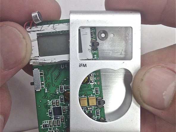

  7. Disassembling Griffin iFM 4027 LCD Screen Cover, Media Player Accessory: crwdns2935265:07crwdnd2935265:01crwdnd2935265:02crwdne2935265:0 Disassembling Griffin iFM 4027 LCD Screen Cover, Media Player Accessory: crwdns2935265:07crwdnd2935265:02crwdnd2935265:02crwdne2935265:0
    • Carefully remove the circuit board and attached LCD component from the device by pulling it towards the open left side.
  8. Disassembling Griffin iFM 4027 LCD Screen Cover: crwdns2935265:08crwdnd2935265:01crwdnd2935265:01crwdne2935265:0
    • Carefully lift the rectangular screen cover off the LCD screen.
After disassembly, the device components should look similar to that which is depicted in the cover image (top right of page).
