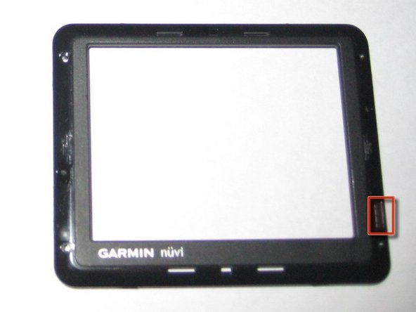

    • Lift cover off of unit.
    • Be careful not to lose small rubber piece on the bottom right corner.
