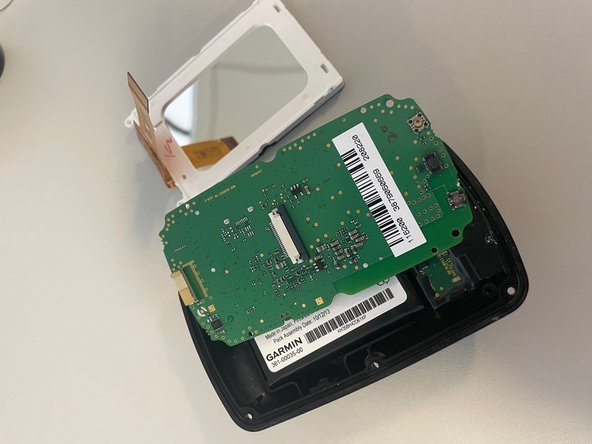

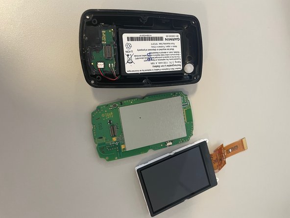

  4. Disassembling Garmin "Edge Touring" Bicycle GPS On/Off Button Failed, Inside the GPS: crwdns2935265:04crwdnd2935265:01crwdnd2935265:03crwdne2935265:0 Disassembling Garmin "Edge Touring" Bicycle GPS On/Off Button Failed, Inside the GPS: crwdns2935265:04crwdnd2935265:02crwdnd2935265:03crwdne2935265:0 Disassembling Garmin "Edge Touring" Bicycle GPS On/Off Button Failed, Inside the GPS: crwdns2935265:04crwdnd2935265:03crwdnd2935265:03crwdne2935265:0
    • The LCD display itself is held on with 2 Torx screws. After removing those, you can lift the screen from the main board. Not much to see here. The cable connector is a friction fit, which can be loosened by pulling the small gray portion toward the bottom of the GPS.
    • The second and third pictures are the parts removed.
