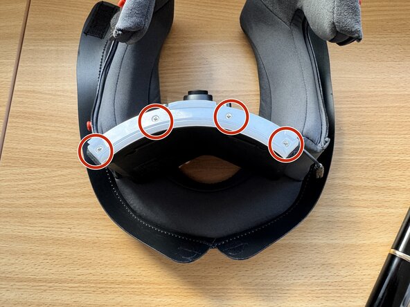

    • Forcite Helmet MK1S camera module. Assuming you have disconnected the speakers, removed the lens with three screws from the outside and four screws (size 0 Phillips) securing the unit inside the helmet.

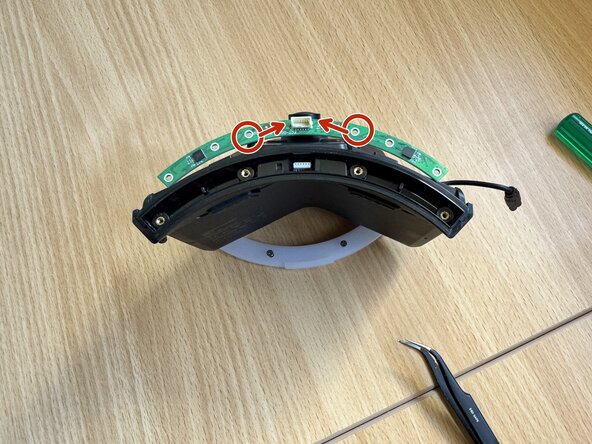

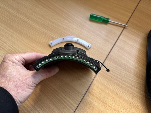

    • Gently remove the rubber cover from the LED strip. This show's it removed by gently prying it free of the three tabs across the front.
    • Remove four (phillips 0) screws holding the LED stip.
    • Remove the LED strip leaving the exposed LEDs. Although this is now free of screws it is now held in place by the plug on the underside of the board. (see next step)
  4. Disassembling Forcite Helmet MK1S (Founders identical) Helmet Camera Module: crwdns2935265:04crwdnd2935265:01crwdnd2935265:03crwdne2935265:0 Disassembling Forcite Helmet MK1S (Founders identical) Helmet Camera Module: crwdns2935265:04crwdnd2935265:02crwdnd2935265:03crwdne2935265:0 Disassembling Forcite Helmet MK1S (Founders identical) Helmet Camera Module: crwdns2935265:04crwdnd2935265:03crwdnd2935265:03crwdne2935265:0
    • To remove this board gently pry it up working alternately from the screw holes either side of the centre. Each time lifting the board towards the centre. This will gently lift the socket off the plug powering the LEDs.

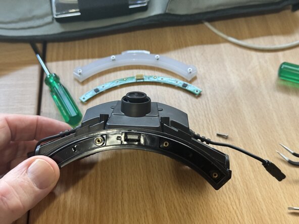

    • After the LED stip is removed
    • Remove the eight (Phillips 0) screws.
    • NOTE the top right screw is behind a warranty sticker.
    • Once the screws are removed, gently separate the front and back cases using a Pick or opening tool or similar.

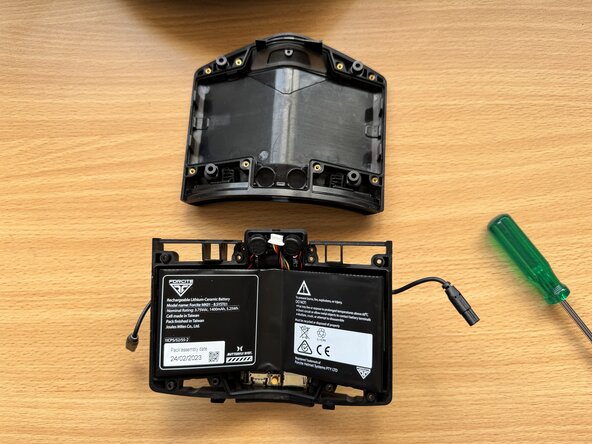

    • CAREFUL when separating the cases, the battery module is loose once they separate and secured only by it's cables that you won't want to damage.
    • The second photo shows the back/inner case above the front/outer case still containing all parts for the module and the battery sitting loose.

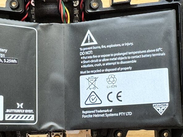

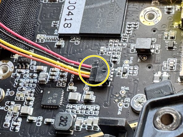

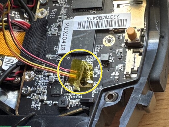

    • The battery module (V-Shaped or butterfly shaped piece) sits loose and can be lifted a small distance out of the case.
    • Gently lift the yellow tape
    • Gently pry the plug from the main board.
  7. Disassembling Forcite Helmet MK1S (Founders identical) Helmet Camera Module: crwdns2935265:07crwdnd2935265:01crwdnd2935265:03crwdne2935265:0 Disassembling Forcite Helmet MK1S (Founders identical) Helmet Camera Module: crwdns2935265:07crwdnd2935265:02crwdnd2935265:03crwdne2935265:0 Disassembling Forcite Helmet MK1S (Founders identical) Helmet Camera Module: crwdns2935265:07crwdnd2935265:03crwdnd2935265:03crwdne2935265:0

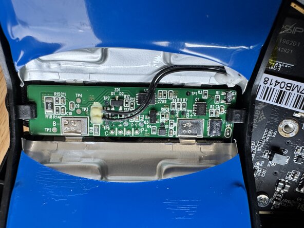

    • The battery is a single V-Shaped module containing two separate batteries with a control board between them.
    • This is as far as my teardown goes and knowledge of battery replacement.
