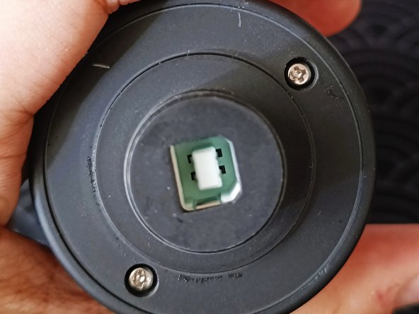

  3. Disassembling Fifine T683 Microphone Body: crwdns2935265:03crwdnd2935265:01crwdnd2935265:02crwdne2935265:0 Disassembling Fifine T683 Microphone Body: crwdns2935265:03crwdnd2935265:02crwdnd2935265:02crwdne2935265:0
    • Remove the hard plastic ring that is covering the 2 phillips screws at the bottom of the unit.
  4. Disassembling Fifine T683 Microphone Body: crwdns2935265:04crwdnd2935265:01crwdnd2935265:01crwdne2935265:0
    • Removing the 2 screws will release the filter. Note that there should be 2 brass poles that connects the two pieces together. One broke in the picture shown as I pried it before.

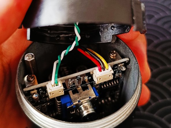

  5. Disassembling Fifine T683 Microphone Body: crwdns2935265:05crwdnd2935265:01crwdnd2935265:02crwdne2935265:0 Disassembling Fifine T683 Microphone Body: crwdns2935265:05crwdnd2935265:02crwdnd2935265:02crwdne2935265:0
    • The condenser is not attached to the casing and is easily removeable. It is connected to the main PCB so do be careful.
  6. Disassembling Fifine T683 Microphone Body: crwdns2935265:06crwdnd2935265:01crwdnd2935265:01crwdne2935265:0
    • Inside you will see another smaller PCB that housed the 3.5mm audio jack. This needs to be removed first before the main PCB as the USB connector is slightly too large to slide through.

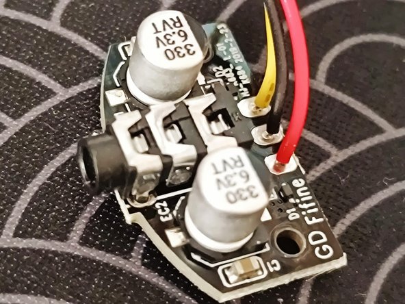

  7. Disassembling Fifine T683 Microphone Body: crwdns2935265:07crwdnd2935265:01crwdnd2935265:02crwdne2935265:0 Disassembling Fifine T683 Microphone Body: crwdns2935265:07crwdnd2935265:02crwdnd2935265:02crwdne2935265:0
    • There two screws to remove the smaller PCB.
