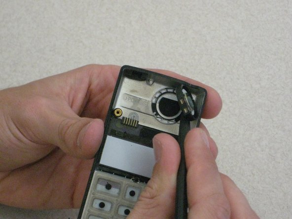

  7. Disassembling Ericsson CF 388 Speaker, Speaker: crwdns2935265:07crwdnd2935265:01crwdnd2935265:01crwdne2935265:0
    • Although it is not completely necessary, removing the plastic keypad skeleton structure helps with the ease of removing the speaker.
    • Locate the speaker at the top of the phone, above the LCD display screen, as shown by the red circle.
  8. Disassembling Ericsson CF 388 Speaker: crwdns2935265:08crwdnd2935265:01crwdnd2935265:02crwdne2935265:0 Disassembling Ericsson CF 388 Speaker: crwdns2935265:08crwdnd2935265:02crwdnd2935265:02crwdne2935265:0
    • To remove the speaker, gently place a plastic pryer tool underneath the speaker.
    • Carefully, lift up the pryer tool to remove the speaker from the adhesive glue connecting to the phone casing.
    • Note: it is preferred to slowly remove the speaker so the speaker is not flung or damaged. Easy does it.
