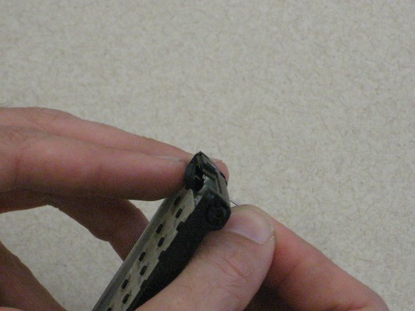

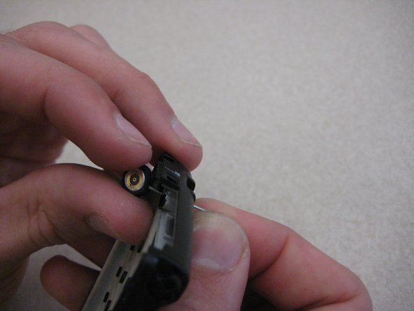

  8. Disassembling Ericsson CF 388 Microphone: crwdns2935265:08crwdnd2935265:01crwdnd2935265:03crwdne2935265:0 Disassembling Ericsson CF 388 Microphone: crwdns2935265:08crwdnd2935265:02crwdnd2935265:03crwdne2935265:0 Disassembling Ericsson CF 388 Microphone: crwdns2935265:08crwdnd2935265:03crwdnd2935265:03crwdne2935265:0
    • To remove the microphone, carefully poke out the microphone through the front hole with a paper clip.
    • Slowly and carefully, push the microphone out.
    • Note: Do not push too hard as it could damage or fling the microphone. You don't want to lose it!
