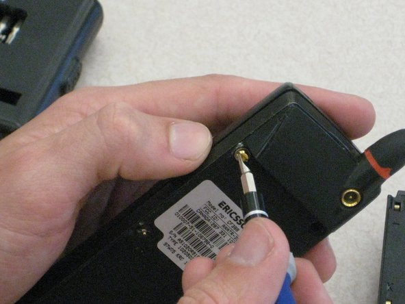

  2. Disassembling Ericsson CF 388 LCD Display Screen, Phone Casing: crwdns2935265:02crwdnd2935265:01crwdnd2935265:03crwdne2935265:0 Disassembling Ericsson CF 388 LCD Display Screen, Phone Casing: crwdns2935265:02crwdnd2935265:02crwdnd2935265:03crwdne2935265:0 Disassembling Ericsson CF 388 LCD Display Screen, Phone Casing: crwdns2935265:02crwdnd2935265:03crwdnd2935265:03crwdne2935265:0
    • After removing the battery, the front phone casing becomes accessible.
    • Locate the two star-shaped T6 screws on the bottom end of the rear of the phone, underneath the battery, as indicated by the red circles.
    • Remove these two screws using the Torx T6 Screwdriver.
  3. Disassembling Ericsson CF 388 LCD Display Screen: crwdns2935265:03crwdnd2935265:01crwdnd2935265:03crwdne2935265:0 Disassembling Ericsson CF 388 LCD Display Screen: crwdns2935265:03crwdnd2935265:02crwdnd2935265:03crwdne2935265:0 Disassembling Ericsson CF 388 LCD Display Screen: crwdns2935265:03crwdnd2935265:03crwdnd2935265:03crwdne2935265:0
    • Locate the top two U-shaped screws on the back of the phone, as shown by the red circles.
    • Remove these two screws with a SP 2.6 screw driver.
    • Note: Remove gray plastic grommets with screws.

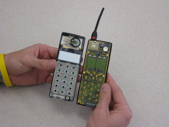

  4. Disassembling Ericsson CF 388 LCD Display Screen: crwdns2935265:04crwdnd2935265:01crwdnd2935265:02crwdne2935265:0 Disassembling Ericsson CF 388 LCD Display Screen: crwdns2935265:04crwdnd2935265:02crwdnd2935265:02crwdne2935265:0
    • Grab opposite panels of the phone casing and carefully open and pull apart the phone, as shown in the image.
    • Note: Be careful not to damage the circuit board and components as you as open the casing.
  5. Disassembling Ericsson CF 388 LCD Display Screen, Keypad Support Skeleton: crwdns2935265:05crwdnd2935265:01crwdnd2935265:02crwdne2935265:0 Disassembling Ericsson CF 388 LCD Display Screen, Keypad Support Skeleton: crwdns2935265:05crwdnd2935265:02crwdnd2935265:02crwdne2935265:0
    • After removing the battery casing and taking apart the phone casing, the keypad is held in with a plastic skeleton structure as shown.

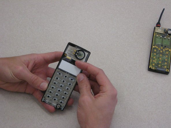

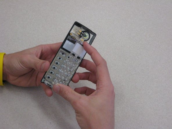

  6. Disassembling Ericsson CF 388 LCD Display Screen: crwdns2935265:06crwdnd2935265:01crwdnd2935265:03crwdne2935265:0 Disassembling Ericsson CF 388 LCD Display Screen: crwdns2935265:06crwdnd2935265:02crwdnd2935265:03crwdne2935265:0 Disassembling Ericsson CF 388 LCD Display Screen: crwdns2935265:06crwdnd2935265:03crwdnd2935265:03crwdne2935265:0
    • To remove the plastic skeleton structure, locate the tab at the top of the phone near the LCD display screen.
    • Carefully remove the skeleton by holding on the front phone casing with one hand and pull tab with your index finger while having your thumb at the bottom of the phone as shown.

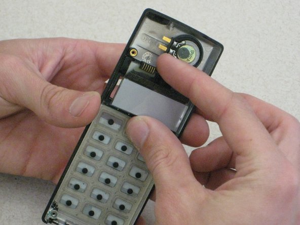

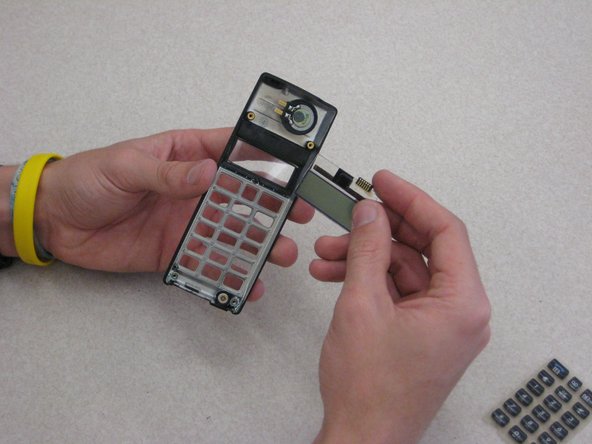

  7. Disassembling Ericsson CF 388 LCD Display Screen, LCD Display Screen: crwdns2935265:07crwdnd2935265:01crwdnd2935265:02crwdne2935265:0 Disassembling Ericsson CF 388 LCD Display Screen, LCD Display Screen: crwdns2935265:07crwdnd2935265:02crwdnd2935265:02crwdne2935265:0
    • After removing the plastic support skeleton, the LCD Display is accessible and easily removed.
    • Locate the screen at the top of the phone as shown.

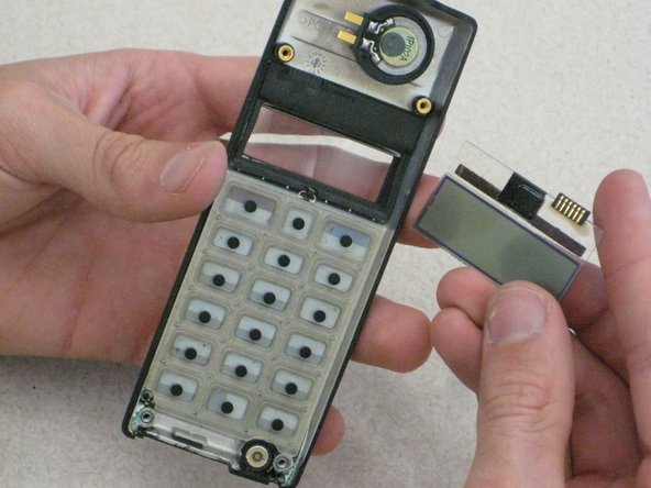

  8. Disassembling Ericsson CF 388 LCD Display Screen: crwdns2935265:08crwdnd2935265:01crwdnd2935265:03crwdne2935265:0 Disassembling Ericsson CF 388 LCD Display Screen: crwdns2935265:08crwdnd2935265:02crwdnd2935265:03crwdne2935265:0 Disassembling Ericsson CF 388 LCD Display Screen: crwdns2935265:08crwdnd2935265:03crwdnd2935265:03crwdne2935265:0
    • Using your index finger and thumb, carefully remove LCD display screen. You may need to use a plastic pry bar to get this started.
