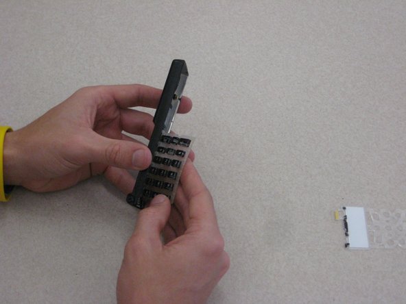

    1. Disassembling Ericsson CF 388 Keypad, Keypad: crwdns2935265:07crwdnd2935265:01crwdnd2935265:02crwdne2935265:0 Disassembling Ericsson CF 388 Keypad, Keypad: crwdns2935265:07crwdnd2935265:02crwdnd2935265:02crwdne2935265:0
      • To remove the keypad, tilt the phone and the keypad will slide out with the orientation shown.
