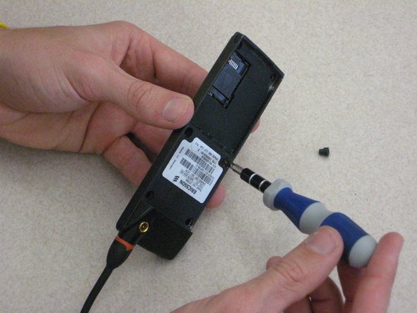

  3. Disassembling Ericsson CF 388 Circuit Board: crwdns2935265:03crwdnd2935265:01crwdnd2935265:03crwdne2935265:0 Disassembling Ericsson CF 388 Circuit Board: crwdns2935265:03crwdnd2935265:02crwdnd2935265:03crwdne2935265:0 Disassembling Ericsson CF 388 Circuit Board: crwdns2935265:03crwdnd2935265:03crwdnd2935265:03crwdne2935265:0
    • Locate the top two U-shaped screws on the back of the phone, as shown by the red circles.
    • Remove these two screws with a SP 2.6 screw driver.
    • Note: Remove gray plastic grommets with screws.

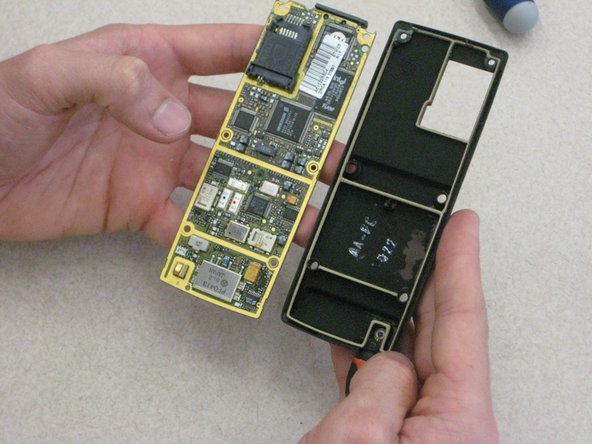

  5. Disassembling Ericsson CF 388 Circuit Board, Circuit Board: crwdns2935265:05crwdnd2935265:01crwdnd2935265:01crwdne2935265:0
    • Locate the circuit board on the rear side of the front phone casing (right side of image).
    • Locate the mounting screws (indicated by red circles), which attach the board to the rear side of the front phone casing.

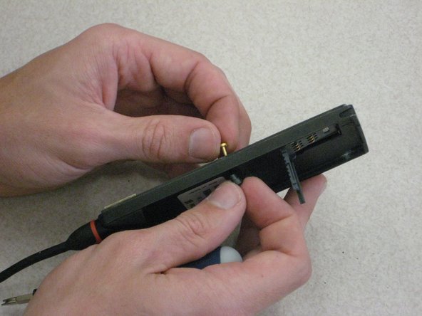

    • Using the SP2.6 u-shaped screw driver in one hand, loosen and remove both center screws. Hold the back part of the screw with the metal tweezers.
  7. Disassembling Ericsson CF 388 Circuit Board: crwdns2935265:07crwdnd2935265:01crwdnd2935265:02crwdne2935265:0 Disassembling Ericsson CF 388 Circuit Board: crwdns2935265:07crwdnd2935265:02crwdnd2935265:02crwdne2935265:0
    • Completely remove the two center screw as shown.
    • Note: the hand not holding the screw driver is holding the back part of the screw and the panel in place.

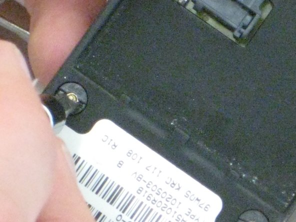

    • Locate the final screw at the top of the phone near the antenna, as shown by the red circle.
    • Using the U-shaped screw driver, remove the top screw.

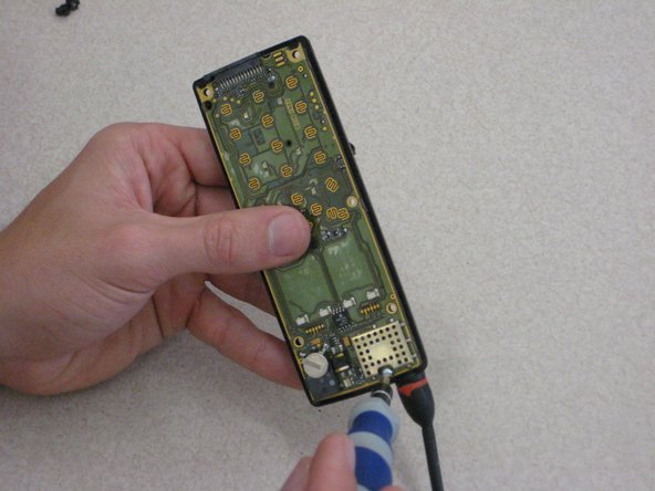

    • With one hand on the circuit board and one hand on the phone casing, carefully pull apart the circuit board from the front panel casing.
