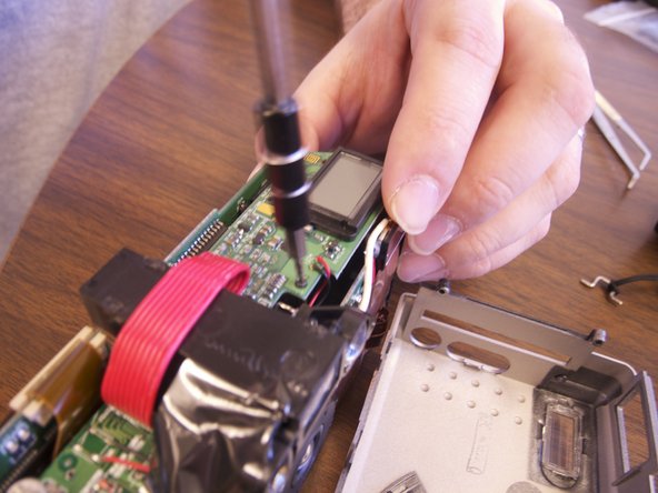

  6. Disassembling Epson PPC650 Replacing Flash, Disassembling Epson PPC650 Replacing Flash: crwdns2935265:06crwdnd2935265:01crwdnd2935265:03crwdne2935265:0 Disassembling Epson PPC650 Replacing Flash, Disassembling Epson PPC650 Replacing Flash: crwdns2935265:06crwdnd2935265:02crwdnd2935265:03crwdne2935265:0 Disassembling Epson PPC650 Replacing Flash, Disassembling Epson PPC650 Replacing Flash: crwdns2935265:06crwdnd2935265:03crwdnd2935265:03crwdne2935265:0
    • Optional: Remove two black screws from top of camera on the flash side for more working space.

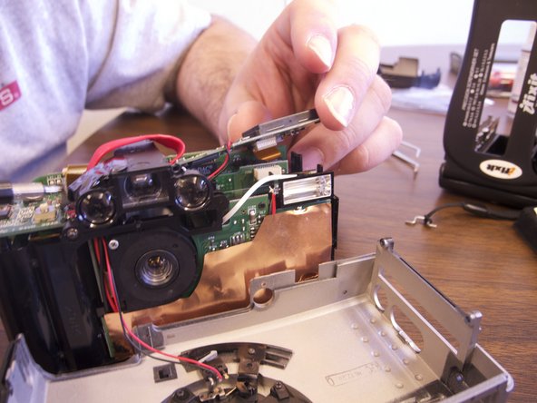

  7. Disassembling Epson PPC650 Replacing Flash: crwdns2935265:07crwdnd2935265:01crwdnd2935265:01crwdne2935265:0
    • Remove clear rubber band holding flash in line with wiring.
    • Cut white wire, red wire, and black wire connecting flash element to circuit board by unsoldering ends
    • Connect new flash by soldering copper ends to their respective ends to new flash element.
