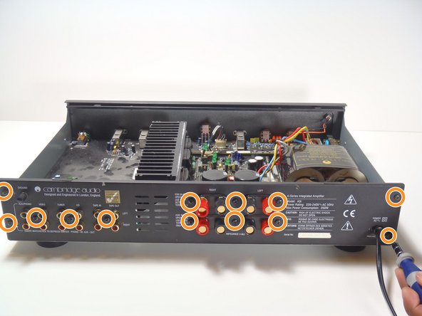

    • Remove 3 screws on bottom of case.
    • Remove 13 screws on rear panel.
    • Do not move the rear panel too far, as the power cord is still connected.
  4. Disassembling Cambridge Audio A3i Case: crwdns2935265:04crwdnd2935265:01crwdnd2935265:01crwdne2935265:0
    • Using a pair of pliers, squeeze the retainer for the power cord as shown and pull it toward the external side the panel.
    • It may require some wiggling, but it should slip out of the hole and then off of the cord.
