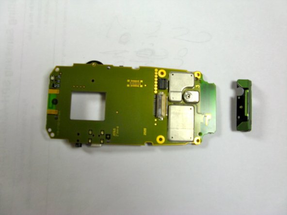

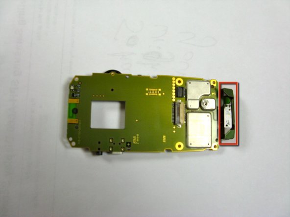

  15. Disassembling Blackberry 7105t Full Dissassembly, Full Dissassembly: crwdns2935265:015crwdnd2935265:01crwdnd2935265:03crwdne2935265:0 Disassembling Blackberry 7105t Full Dissassembly, Full Dissassembly: crwdns2935265:015crwdnd2935265:02crwdnd2935265:03crwdne2935265:0 Disassembling Blackberry 7105t Full Dissassembly, Full Dissassembly: crwdns2935265:015crwdnd2935265:03crwdnd2935265:03crwdne2935265:0
    • Use a spudger or your fingernails to push outwards against one of the black clips. The plastic end cap should fall easily away.
