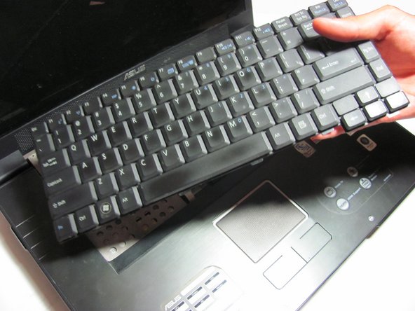

    2. Disassembling Asus W2W-A1 Protective Cover: crwdns2935265:02crwdnd2935265:01crwdnd2935265:01crwdne2935265:0
      • Remove the panel above the keyboard with a plastic spudger.
    3. Disassembling Asus W2W-A1 Protective Cover: crwdns2935265:03crwdnd2935265:01crwdnd2935265:01crwdne2935265:0
      • Once the panel is removed, use the spudger to pry out the keyboard.
      • Do not fully remove, for the keyboard is still attached to the ribbon cable.
    4. Disassembling Asus W2W-A1 Protective Cover: crwdns2935265:04crwdnd2935265:01crwdnd2935265:02crwdne2935265:0 Disassembling Asus W2W-A1 Protective Cover: crwdns2935265:04crwdnd2935265:02crwdnd2935265:02crwdne2935265:0
      • Detach the ribbon cable from the keyboard by pulling the end of the ribbon cable that is attached inside of the laptop.
      • Be sure to detach from the root rather than from near the middle. It should slide out with ease.
      • Now you can fully remove the keyboard from the laptop.

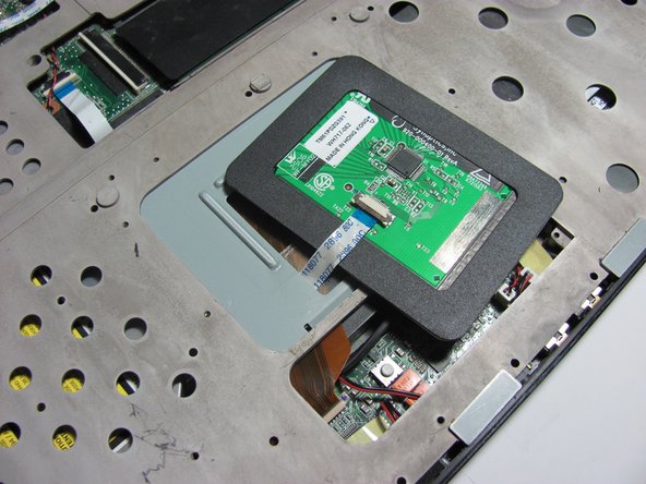

    1. Disassembling Asus W2W-A1 Protective Cover, Touchpad: crwdns2935265:06crwdnd2935265:01crwdnd2935265:02crwdne2935265:0 Disassembling Asus W2W-A1 Protective Cover, Touchpad: crwdns2935265:06crwdnd2935265:02crwdnd2935265:02crwdne2935265:0
      • The touchpad should be loosely attached to the rest of the laptop by a ribbon cable.
    2. Disassembling Asus W2W-A1 Protective Cover: crwdns2935265:07crwdnd2935265:01crwdnd2935265:01crwdne2935265:0
      • Gently pull the ribbon cable out of its socket attached to the touchpad.
      • You are now able to remove the touchpad.

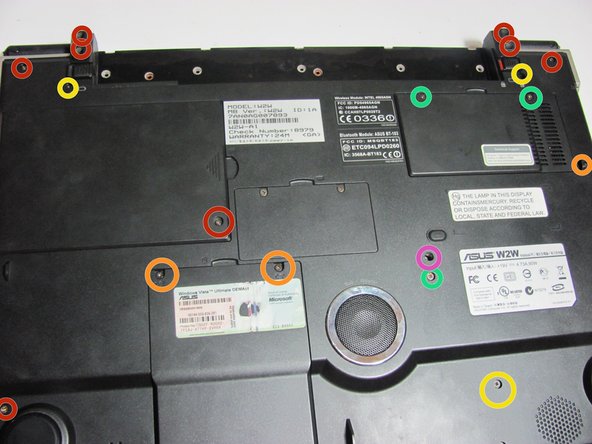

    2. Disassembling Asus W2W-A1 Protective Cover: crwdns2935265:09crwdnd2935265:01crwdnd2935265:03crwdne2935265:0 Disassembling Asus W2W-A1 Protective Cover: crwdns2935265:09crwdnd2935265:02crwdnd2935265:03crwdne2935265:0 Disassembling Asus W2W-A1 Protective Cover: crwdns2935265:09crwdnd2935265:03crwdnd2935265:03crwdne2935265:0
      • There are many different types of screws in this step so make sure to arrange the screws by their different sizes.
      • Unscrew the six 17 mm Phillips head screws on the stands on the back and the 2 "A" screws of the same size adjacent to the stands.
      • Unscrew the two C Phillips head screws on the hard drive panel. There is also one more C screw in the upper right corner of the laptop as shown.
      • Unscrew the eight 8mm lock phillips screws and the screws along the outside of the laptop.
      • Unscrew the three 3mm E Phillips screw and the one 3mm D Phillips screw.
      • Unscrew the 5mm Phillips head screw that lies just above the D screw.

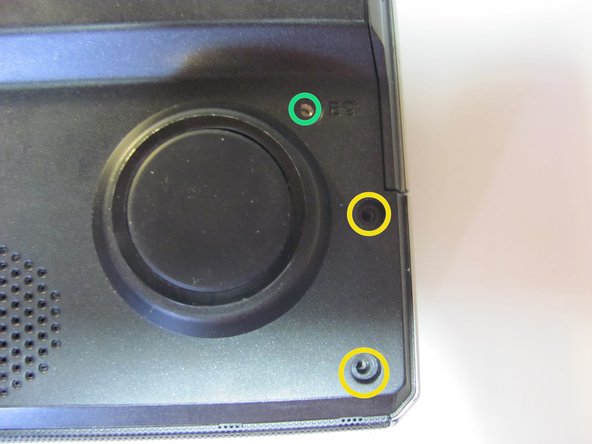

    3. Disassembling Asus W2W-A1 Protective Cover: crwdns2935265:010crwdnd2935265:01crwdnd2935265:01crwdne2935265:0
      • Unscrew the two 8 mm Phillips screws beneath the hard drive panel.
      • After finishing this step, flip the laptop over.
