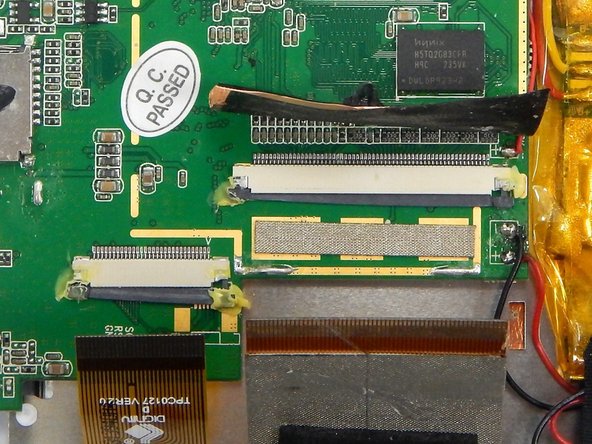

  4. Disassembling Arnova 7K G3 Logic Board Ribbon Connectors, Disassembling Arnova 7K G3 Logic Board Ribbon Connectors: crwdns2935265:04crwdnd2935265:01crwdnd2935265:02crwdne2935265:0 Disassembling Arnova 7K G3 Logic Board Ribbon Connectors, Disassembling Arnova 7K G3 Logic Board Ribbon Connectors: crwdns2935265:04crwdnd2935265:02crwdnd2935265:02crwdne2935265:0
    • Peel the copper tape covering the ribbon connector with a set of tweezers.
  5. Disassembling Arnova 7K G3 Logic Board Ribbon Connectors: crwdns2935265:05crwdnd2935265:01crwdnd2935265:03crwdne2935265:0 Disassembling Arnova 7K G3 Logic Board Ribbon Connectors: crwdns2935265:05crwdnd2935265:02crwdnd2935265:03crwdne2935265:0 Disassembling Arnova 7K G3 Logic Board Ribbon Connectors: crwdns2935265:05crwdnd2935265:03crwdnd2935265:03crwdne2935265:0
    • Locate the two gray pins on the ribbon connector.
    • Grab the first pin with tweezers and gently pull it towards the ribbon. Repeat the step.
    • Gently pull the ribbon cable out of the connection port.
  6. Disassembling Arnova 7K G3 Logic Board Ribbon Connectors: crwdns2935265:06crwdnd2935265:01crwdnd2935265:03crwdne2935265:0 Disassembling Arnova 7K G3 Logic Board Ribbon Connectors: crwdns2935265:06crwdnd2935265:02crwdnd2935265:03crwdne2935265:0 Disassembling Arnova 7K G3 Logic Board Ribbon Connectors: crwdns2935265:06crwdnd2935265:03crwdnd2935265:03crwdne2935265:0
    • Locate the ribbon connector two.
    • Locate the pins of ribbon connector two. Repeat step two for unlocking the pins.
    • Gently pull the ribbon out of the connection port.
