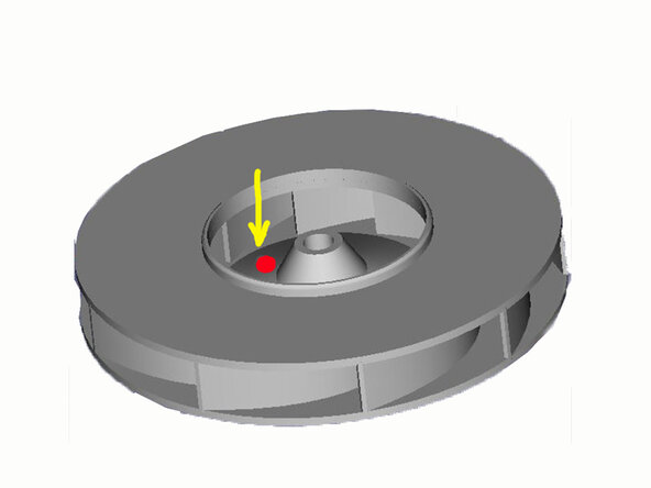

π Step 2: Access the Impeller Housing
- Remove the vacuum casing to expose the motor and impeller.
- The impeller casing consists of a rubber cover that easily comes off and a plastic cover around the impeller that easily opens up.
- Check if the impeller housing is loose or wobbling.
π οΈ Step 3: Drill an Access Hole
- Identify the location of the screws securing the impeller housing to the motor.
- Carefully drill a small hole into the impeller base, just large enough for a screwdriver to pass through.
π‘ Tip: Use a low-speed drill and steady pressure to avoid damaging the impeller.
π© Step 4: Tighten the Screws
- Insert a small screwdriver through the hole.
- Tighten both screws until the housing is secure.
