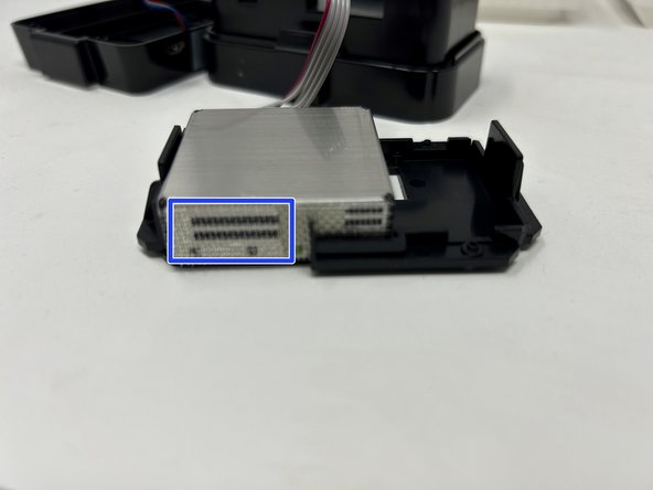

      • Looking at the sensor from the bottom, you can see the two tabs/prongs that hold the outer case together.
      • There is a fine cable attaching the internal components of the PM sensor. Be careful not to disrupt/break it.
      • The internal housing will now be exposed. You can use the two tabs/prongs on this porting to remove that portion of the case.
      • Next, you can remove the 4 small screws holding the internal components to the outer shell.
    2. Disassembling Ambient Weather AQIN Particulate Sensor: crwdns2935265:02crwdnd2935265:01crwdnd2935265:02crwdne2935265:0 Disassembling Ambient Weather AQIN Particulate Sensor: crwdns2935265:02crwdnd2935265:02crwdnd2935265:02crwdne2935265:0
      • Once the unit is disassembled, you can locate the internal motor of the unit.
      • Using compressed air, you may remove any debris that has become lodged on the intake shield of the motor.
