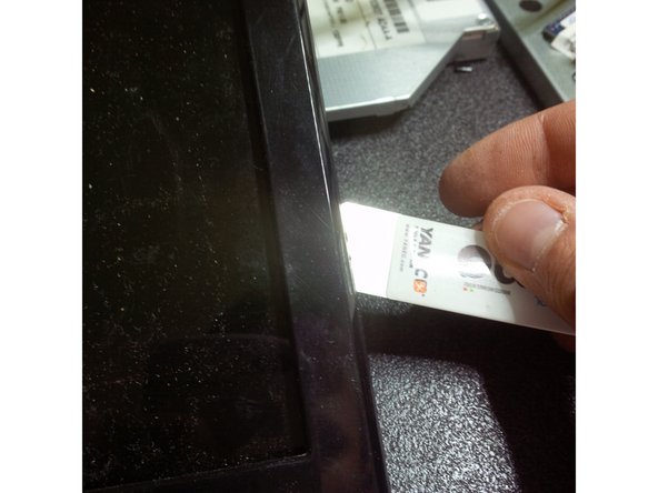

  12. Disassembling Acer Aspire 7551G, removing the screen: crwdns2935265:012crwdnd2935265:01crwdnd2935265:03crwdne2935265:0 Disassembling Acer Aspire 7551G, removing the screen: crwdns2935265:012crwdnd2935265:02crwdnd2935265:03crwdne2935265:0 Disassembling Acer Aspire 7551G, removing the screen: crwdns2935265:012crwdnd2935265:03crwdnd2935265:03crwdne2935265:0
    • Remove all black plastic stickers to reveal the hidden screws.
    • Use Phillips #000 Screwdriver to remove the hidden screws.
    • Carefully slide your prybar under the edge and gently pry around the perimeter.
    • Remove the cable from the webcam module
    • Remove the screws that hold the screen to the inner frame.
    • Apply gentle pressure when undoing the screws to preserve the condition of screw heads for future repairs or servicing.
