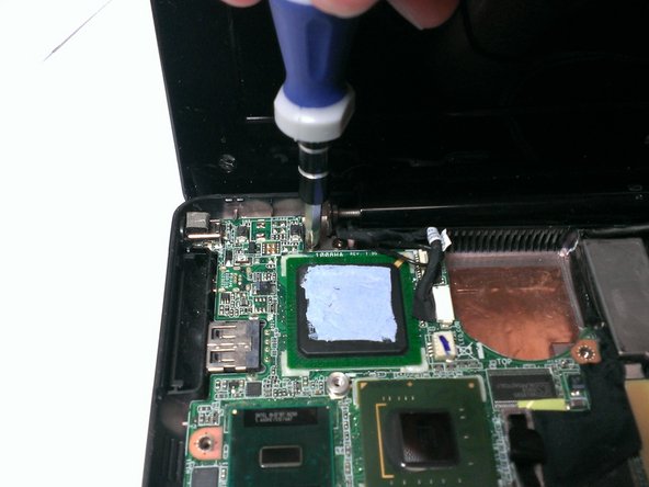

  4. Disassembling ASUS Eee pc 1008Ha: crwdns2935265:04crwdnd2935265:01crwdnd2935265:02crwdne2935265:0 Disassembling ASUS Eee pc 1008Ha: crwdns2935265:04crwdnd2935265:02crwdnd2935265:02crwdne2935265:0
    • Heat sink: Use a Phillips head screwdriver to unscrew the screws that connect the heat sink to the fan.
    • Use a Flathead Screwdriver to gently lift the copper heat sink and use your fingers to remove it from the laptop.

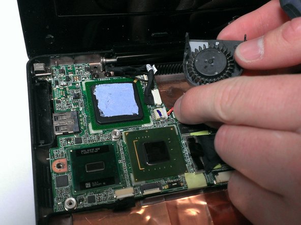

  5. Disassembling ASUS Eee pc 1008Ha: crwdns2935265:05crwdnd2935265:01crwdnd2935265:02crwdne2935265:0 Disassembling ASUS Eee pc 1008Ha: crwdns2935265:05crwdnd2935265:02crwdnd2935265:02crwdne2935265:0
    • Fan: Unscrew the screws that secure the fan.
    • Use your fingers to lift the fan and pull the white plug carefully from the motherboard.

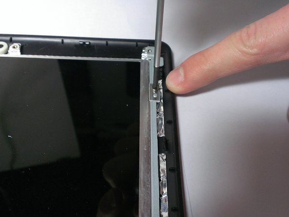

  10. Disassembling ASUS Eee pc 1008Ha: crwdns2935265:010crwdnd2935265:01crwdnd2935265:02crwdne2935265:0 Disassembling ASUS Eee pc 1008Ha: crwdns2935265:010crwdnd2935265:02crwdnd2935265:02crwdne2935265:0
    • Use a Flathead Screwdriver to pry off the chits from the front panel. (The chits are the small black rubber caps.)
    • Unscrew the screws that connect the front panel of the screen.

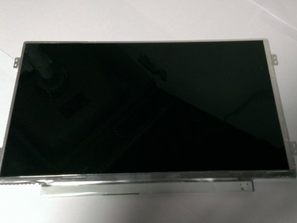

  11. Disassembling ASUS Eee pc 1008Ha: crwdns2935265:011crwdnd2935265:01crwdnd2935265:01crwdne2935265:0
    • Slide the Plastic Opening Tool under the edge of the screen bezel to release the front panel of the screen.

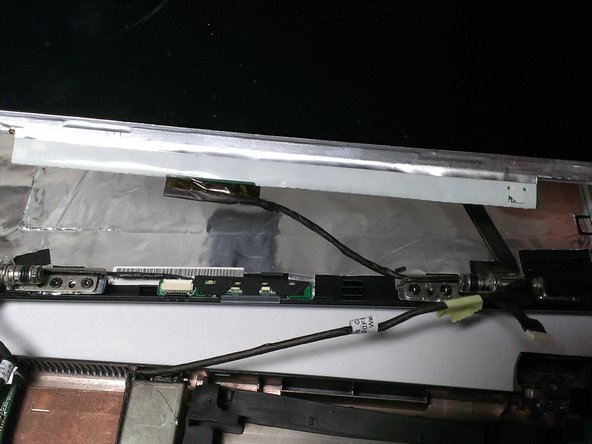

  12. Disassembling ASUS Eee pc 1008Ha: crwdns2935265:012crwdnd2935265:01crwdnd2935265:03crwdne2935265:0 Disassembling ASUS Eee pc 1008Ha: crwdns2935265:012crwdnd2935265:02crwdnd2935265:03crwdne2935265:0 Disassembling ASUS Eee pc 1008Ha: crwdns2935265:012crwdnd2935265:03crwdnd2935265:03crwdne2935265:0
    • Unscrew the screws from the edge of the screen.
    • Use your fingers to hold the screen and remove it from the base. (Wires will still be attached between the screen and the motherboard.)

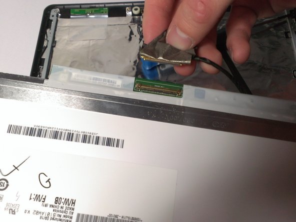

  13. Disassembling ASUS Eee pc 1008Ha: crwdns2935265:013crwdnd2935265:01crwdnd2935265:03crwdne2935265:0 Disassembling ASUS Eee pc 1008Ha: crwdns2935265:013crwdnd2935265:02crwdnd2935265:03crwdne2935265:0 Disassembling ASUS Eee pc 1008Ha: crwdns2935265:013crwdnd2935265:03crwdnd2935265:03crwdne2935265:0
    • Use your fingers to remove the adhesive tape located on the back of the screen near the wire connection.
    • Disconnect the wire from the screen.
