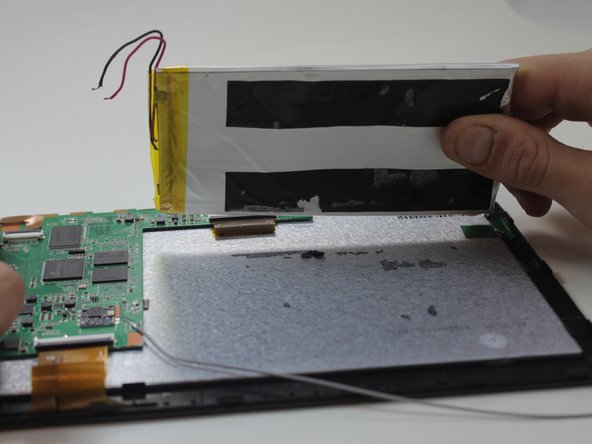

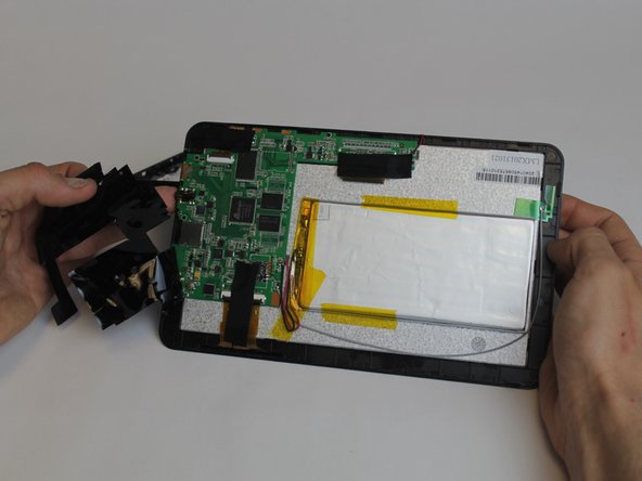

    1. Disassembling APEX AP-GS918 Screen, Battery: crwdns2935265:04crwdnd2935265:01crwdnd2935265:02crwdne2935265:0 Disassembling APEX AP-GS918 Screen, Battery: crwdns2935265:04crwdnd2935265:02crwdnd2935265:02crwdne2935265:0
      • Begin removing the black tape covering the motherboard inside the tablet.

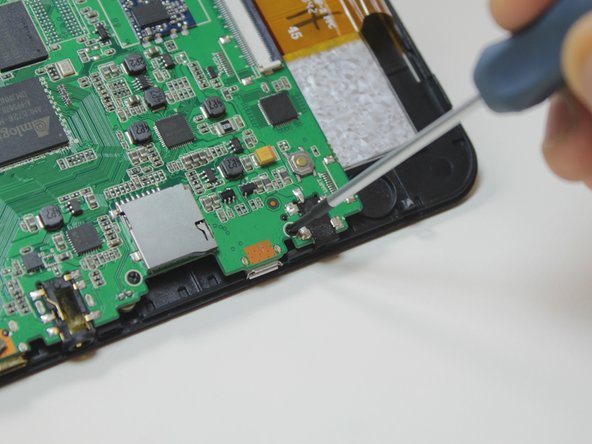

    2. Disassembling APEX AP-GS918 Screen: crwdns2935265:05crwdnd2935265:01crwdnd2935265:01crwdne2935265:0
      • You will need to desolder the two contact points that connect the battery to the mother board.
      • Make sure to allow ample time (at least 5-8 minutes or more) for the soldering iron to heat up. Otherwise, the solder won't melt.
      • Touch the hot iron to the contact points and gently pull on the wires to loosen them from the solder. They should release easily.
      • Make sure not to touch the contact points after desoldering them because they will remain very hot for a short while afterwards.
    3. Disassembling APEX AP-GS918 Screen: crwdns2935265:06crwdnd2935265:01crwdnd2935265:02crwdne2935265:0 Disassembling APEX AP-GS918 Screen: crwdns2935265:06crwdnd2935265:02crwdnd2935265:02crwdne2935265:0
      • Using the black nylon spudger, get underneath the battery and begin prying it loose from the rest of the tablet.
      • The tape holding the battery to the tablet has a very strong hold so be prepared for resistance.

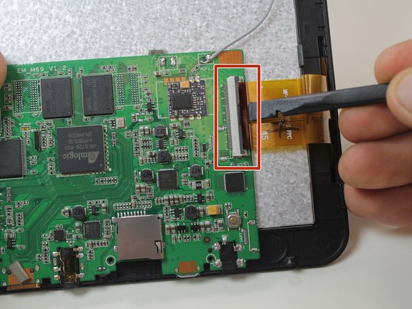

    1. Disassembling APEX AP-GS918 Screen, Screen: crwdns2935265:07crwdnd2935265:01crwdnd2935265:02crwdne2935265:0 Disassembling APEX AP-GS918 Screen, Screen: crwdns2935265:07crwdnd2935265:02crwdnd2935265:02crwdne2935265:0
      • The motherboard will need to be removed in order to access the screen.
      • To remove the motherboard you must first unscrew four 4.9mm Phillips #00 screws.
    2. Disassembling APEX AP-GS918 Screen: crwdns2935265:08crwdnd2935265:01crwdnd2935265:02crwdne2935265:0 Disassembling APEX AP-GS918 Screen: crwdns2935265:08crwdnd2935265:02crwdnd2935265:02crwdne2935265:0
      • To finish removing the motherboard you must release the two data cables holding the screen to it.
      • Use the black nylon spudger to lift the gray clips up 90° on the white connectors.
      • You can now remove the data cables from the slots and lift the motherboard out from the device.

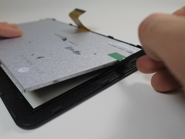

    3. Disassembling APEX AP-GS918 Screen: crwdns2935265:09crwdnd2935265:01crwdnd2935265:02crwdne2935265:0 Disassembling APEX AP-GS918 Screen: crwdns2935265:09crwdnd2935265:02crwdnd2935265:02crwdne2935265:0
      • After removing the motherboard, use the black nylon spudger to pop the screen out of the housing holding it to the front of the screen case.
    4. Disassembling APEX AP-GS918 Screen: crwdns2935265:010crwdnd2935265:01crwdnd2935265:01crwdne2935265:0
      • Pull the thin plastic screen casing apart and you can remove the damaged screen.
