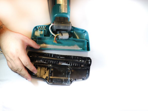

    • Use a Phillips #0 screwdriver to remove each screw.
  3. Dirt Devil Vibe Vacuum  Brush Roller  Replacement: crwdns2935265:03crwdnd2935265:01crwdnd2935265:03crwdne2935265:0 Dirt Devil Vibe Vacuum  Brush Roller  Replacement: crwdns2935265:03crwdnd2935265:02crwdnd2935265:03crwdne2935265:0 Dirt Devil Vibe Vacuum  Brush Roller  Replacement: crwdns2935265:03crwdnd2935265:03crwdnd2935265:03crwdne2935265:0

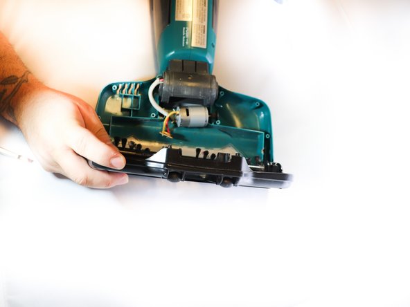

    • After removing all of the screws pull the vacuum's black cover up to remove it.
  4. Dirt Devil Vibe Vacuum  Brush Roller  Replacement: crwdns2935265:04crwdnd2935265:01crwdnd2935265:02crwdne2935265:0 Dirt Devil Vibe Vacuum  Brush Roller  Replacement: crwdns2935265:04crwdnd2935265:02crwdnd2935265:02crwdne2935265:0
    • Pull the brush roll up to remove from the black cover.
  5. Dirt Devil Vibe Vacuum  Brush Roller  Replacement: crwdns2935265:05crwdnd2935265:01crwdnd2935265:01crwdne2935265:0
    • Replace the brush roll with a new brush roll.
