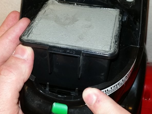

    • At the bottom of the now vacant dust cup holder, locate the filter assembly and shroud. It is located just above the "Performance Indicator"
    • Pull up on the latch indicated and remove the shroud.
    • Be aware of any dust that may come off of the HEPA filter.
  3. Dirt Devil UD20005 Suction Path Replacement: crwdns2935265:03crwdnd2935265:01crwdnd2935265:02crwdne2935265:0 Dirt Devil UD20005 Suction Path Replacement: crwdns2935265:03crwdnd2935265:02crwdnd2935265:02crwdne2935265:0
    • Putting the shroud aside, use two fingers on the edges of the filter assembly to lift the rest of it out of its housing.
    • Note the slot that must line up with the filter during reassembly.

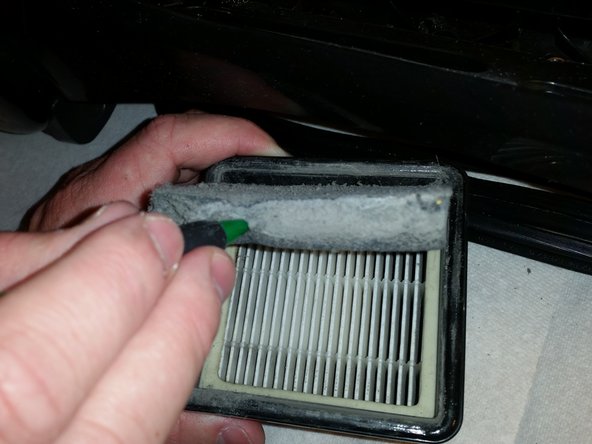

  4. Dirt Devil UD20005 Suction Path Replacement: crwdns2935265:04crwdnd2935265:01crwdnd2935265:02crwdne2935265:0 Dirt Devil UD20005 Suction Path Replacement: crwdns2935265:04crwdnd2935265:02crwdnd2935265:02crwdne2935265:0
    • Use a prying tool, such as a spudger, to separate the foam filter from the larger HEPA filter.
    • As mentioned previously, a lot of fine dust can kick up during this step, especially if your vacuum is extremely dirty. Consider using a mask if necessary.
    • The picture shows a pencil being used, which works fine, but take care to not puncture or otherwise damage the foam filter.
    • Set both of these aside with the rest of the filter assembly for cleaning later.

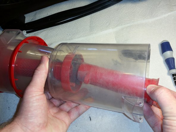

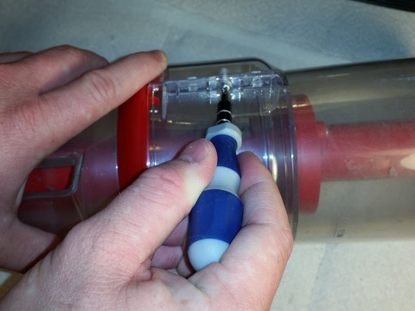

  5. Dirt Devil UD20005 Suction Path Replacement, Dust Cup: crwdns2935265:05crwdnd2935265:01crwdnd2935265:02crwdne2935265:0 Dirt Devil UD20005 Suction Path Replacement, Dust Cup: crwdns2935265:05crwdnd2935265:02crwdnd2935265:02crwdne2935265:0
    • Use a Phillips #2 Screwdriver to remove the dust cup shroud.
    • The shroud is cosmetic, but this will make future steps easier.
    • Remove the shroud by sliding it downwards over the dust cup slowly, working it off, being careful not to let it over-extend.

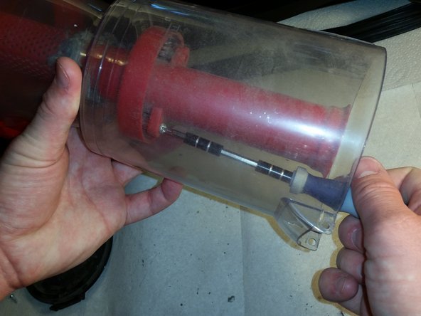

    • With the hinged door removed, look into the dust cup and locate the two screws holding the cyclonic funnel in place.
    • Use a #2 Phillips Screwdriver to remove them. The funnel will remove easily, place it aside for cleaning when finished.

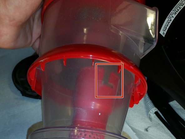

  8. Dirt Devil UD20005 Suction Path Replacement: crwdns2935265:08crwdnd2935265:01crwdnd2935265:02crwdne2935265:0 Dirt Devil UD20005 Suction Path Replacement: crwdns2935265:08crwdnd2935265:02crwdnd2935265:02crwdne2935265:0
    • Grip the dust collector with your hand firmly, looking for the twist-lock that attaches it to the top of the dust cup.
    • Twist it clockwise and remove, setting it aside for cleaning.
