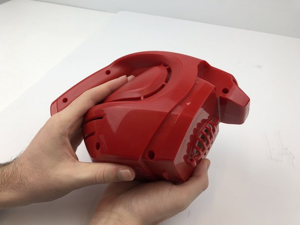

    • Press the button found at the top of the vacuum to separate the suction cup and the motor halves.
  2. Dirt Devil Gator Motor Replacement: crwdns2935265:02crwdnd2935265:01crwdnd2935265:03crwdne2935265:0 Dirt Devil Gator Motor Replacement: crwdns2935265:02crwdnd2935265:02crwdnd2935265:03crwdne2935265:0 Dirt Devil Gator Motor Replacement: crwdns2935265:02crwdnd2935265:03crwdnd2935265:03crwdne2935265:0
    • Pull apart the two halves to obtain the back half and set the front half aside

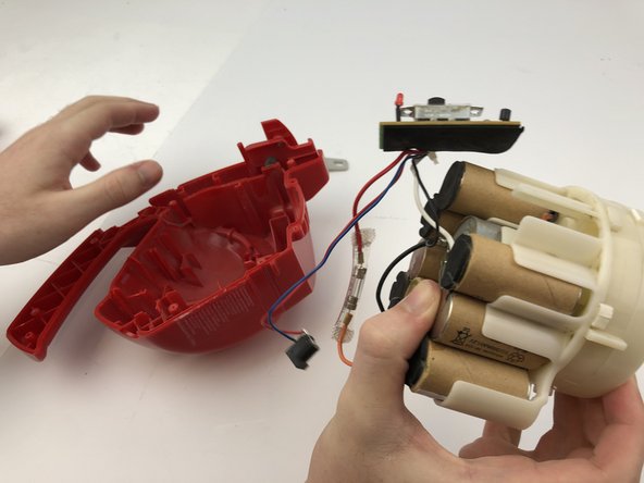

  3. Dirt Devil Gator Motor Replacement: crwdns2935265:03crwdnd2935265:01crwdnd2935265:03crwdne2935265:0 Dirt Devil Gator Motor Replacement: crwdns2935265:03crwdnd2935265:02crwdnd2935265:03crwdne2935265:0 Dirt Devil Gator Motor Replacement: crwdns2935265:03crwdnd2935265:03crwdnd2935265:03crwdne2935265:0
    • Unscrew each of the 13 mm screws with the micro screwdriver.
    • Once unscrewed, pull the case of the Dirt Devil Gator apart.

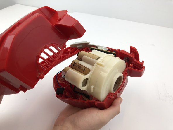

  4. Dirt Devil Gator Motor Replacement: crwdns2935265:04crwdnd2935265:01crwdnd2935265:03crwdne2935265:0 Dirt Devil Gator Motor Replacement: crwdns2935265:04crwdnd2935265:02crwdnd2935265:03crwdne2935265:0 Dirt Devil Gator Motor Replacement: crwdns2935265:04crwdnd2935265:03crwdnd2935265:03crwdne2935265:0
    • Pull out the grey switch and circuit board from its slot in the red case.
    • Remove all of the wires from the vacuum to where only the battery and wires are left.
    • Firmly pull out the battery and motor assembly. The circuit board and wires will remain attached.

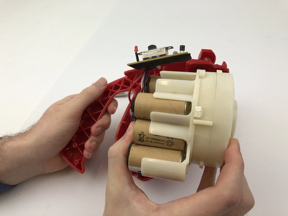

  5. Dirt Devil Gator Motor Replacement: crwdns2935265:05crwdnd2935265:01crwdnd2935265:01crwdne2935265:0
    • Remove the motor from the Dirt Devil Gator exterior by pulling slightly on the white socket.
    • Replace it with a new motor by fitting the motor back into its socket.
    • Be cautious when handling the batteries and wires.
    • Keep the grey on-off switch in the "off" position to ensure a quick reassembly.
